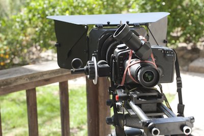

One effective way to get critical focus if you are not dealing with a moving target, is to actually focus through the prism view finder, before locking the mirror up to go to Live View... this seems to work well.
I found it difficult at best to use the 5d viewfinder, especially with a hoodman attached. I now use an Angle Finder C (Canon), which provides 1.25x and 2.5x magnification. I work on the left side of the camera with the follow focus and have great results. Check out the pic.
I'm curious, what follow focus, rails, and matte box are you using?

Here's the link
Cine follow focus sunshade kit for D90 canon 5d mark II - eBay (item 350184027844 end time Apr-03-09 20:41:44 PDT)
A company from India ... great price (under $700 + shipping $45). The quality is good, no problems, everything works, got it within a week after I ordered. Contact me directly if you want to come and see it.
rjwaylonis@mac.com

If you only were living closer to me, I'd like to check it out (but I'm in Bay Area). Do you happen to have more pictures of it? I also wonder if you could measure the upper french flag's width for me? Are you still happy with the follow focus?
