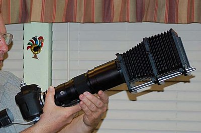

I will post some preliminary test shots I took with the a combo I would have thought was going to be pretty poor. In a howling win, I took a 400mm Vivitar T lens and added a 2x adapter, also by Vivitar. When I could keep the camera still from the wind, I think the images were pretty good, in comparison with shots with telephoto adapters I use to use on my FX1. As I said, I will post some examples this evening..

This is a test using the Canon 5D Mark II, with a Vivitar T system 400mm lens with a Nikon mount. Mounted with a Vivitar 2x adapter bought for $15.00 or so on Ebay. Shot in 30p. Not sure how vimeo will handle change to 24p. But I am tickled that not a lot of CA is showing up. This appears to provide a better image than what I could get out of my FX1 with a teleextender on it.

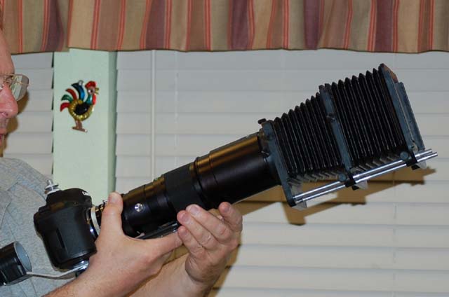

Of course this Vivitar is your standard run of the mill telephoto. See pic attached
