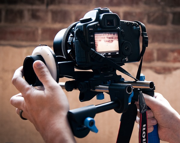

Here's a shot of how I have the rig currently configured. I have the top handle on simply to lean and rest my temple on while shooting. It's quite stable that way.

Thats looks pretty compact compared to the cage setup..
Thanks for the pic...

-Peer, isn't this the complete RedRock field kit reconfigured? $1995?
-Glen thanks for the pic, look like a winner, even at that price (As compared to the Cine City version I mean) I'm still sitting on the fence on this at the moment though.
One question if you would, can this be mounted on a tripod as it is right now? Looking at the Zacuto stockshooter etc. things, they had one where you could just lift it off the tripod and go shoulder mounted. If you could do that with your RedRock field rig, it would be the winner for me.

You can glean through the posts by Glen but he says he has the Field Kit, but the cage
is a little too much, so he took some of the parts away and came up with the setup he
has shown in the picture... so I guess cost wise it would be to take away the three cage
spreaders and a couple of rods... and you get what you see..
The bottom of the shoulder mount is where the tripod hooks... you can see the dove tail
at the bottom of the shoulder mount lined up with the blue tightener...

Good questions. I considered the same thing for myself (returning the field rig) and custom building it. However the price would be very close unfortunately- they discount the individual parts in the kits. I only scrapped (well stored, who know's when/if I'll need them in the future) two sets of rails (a 12" and a 9") and 3 sets of those L-brackets that make the cage.
I liked the feel of the shoulder pad being on the same level as the camera- it lines the LCD up better with my eyes. However I like the grips a bit lower so I connected them on a separate set of rails below.
I also added another Q/R plate to disconnect the grips when mounting to a tripod. I can simply slide them off and use the existing plate to mount to a tripod. It's true the dove-tail on the shoulder pad is a mount point for a tripod plate but it's far from efficient. It's wayyyy to front heavy and the rig itself is a bit heavy for a 501/503 bogen head(s).
I find without the cage and grips it's a bit lighter and it's not as front heavy if I leave the shoulder pad on (which helps counter-balance it). You can kind of see it in this image though the shoulder pad is being obscured by the shadows.
Still I find the rig a bit front heavy while shooting handheld with it. I may have to invest in an accessory cheese plate and weights (which the latter I'm told by RedRock will be available in a few weeks).
Overall I feel it was a good investment. It definitely makes it much more manageable to shoot handheld. I like the idea another poster mentioned about using a loupe instead of the top handle. That will definitely be beneficial outdoors- kill two birds with one stone. While it's quite stable it feels all that much more stable with an additional point of contact. At that point it feels as solid as an appendage.
