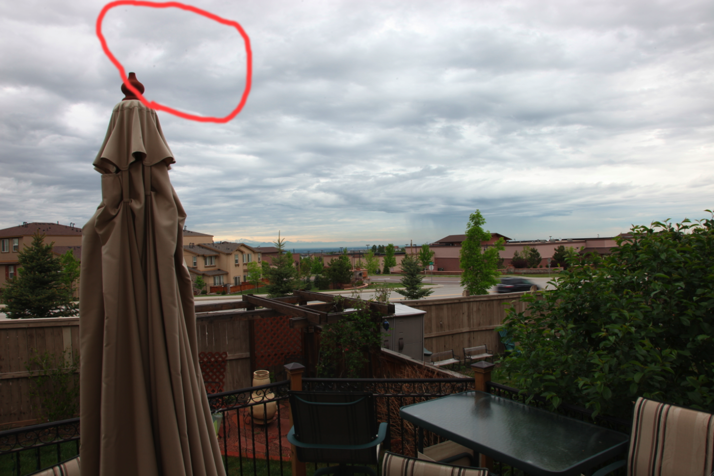

Anyone have any luck cleaning the image sensor? I have babied my 5dII since I got it a few weeks ago. When I am not shooting I always keep it in my zipped bag. I change the lens out frequently, but am always careful not to let any dust get into the camera body when doing so. Despite all of my efforts, my image sensor is riddled with spots! Anybody had any luck getting rid of these eye sores?
I have attached a still image for reference. It is even worse in video and pretty much makes any video shot with the cam unusable now. I have tried compressed air with minimal results. I need these stupid spots gone. Please help!

Thanks for the thread and the info Chris! Any recommendations on a decent, all-around cleaning combo? I have attached a link to a vid as well to show just how bad it is with video.
http://www.ryan-mueller.com/videos/spots.mov
Watch the sky and my son's forehead. Tons of spots! It just blows my mind how quickly the dust builds inside the camera. Especially with how much I baby this camera. I have had my XL2s for a couple of years now and have not had one single problem with dust.I change lenses on the XL2s almost as frequently as the 5DII. I guess the larger image sensor, OK gigantic image sensor, is the culprit here? My pops has had a Canon Rebel for a few years now and does not have this bad of a problem.
