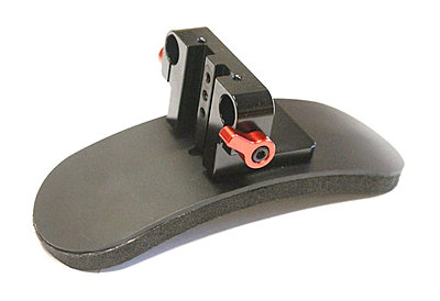

Originally Posted by Alf Pryor View Post
I'm looking for a way to stabilize my 5d for hand held shoots. I've been looking for either a shoulder mounted rig or a steady/glide cam of some sorts.
Over the years I've tried quite a few contraptions for handheld -- one of which was the Varizoom Ultralite: VariZoom VZ UltraLite
(scroll down to see pictures). It took forever to set up right, and even with a bare-bone 5D2, I could not shoot more than a minute or so -- it was simply too heavy for me.
Nowadays, for my handheld I either go with a bare-bone camera with a wide lens (20mm), or use my big Redrock rig (rails, follow-focus, etc.) with a shoulder pad and handles. Here's the pad I got:
www.NoPEER.com
Old July 12th, 2011, 10:47 AM   #23
Posts: 27,382
Re: need stabilization help....
Attachment belongs to post above...
