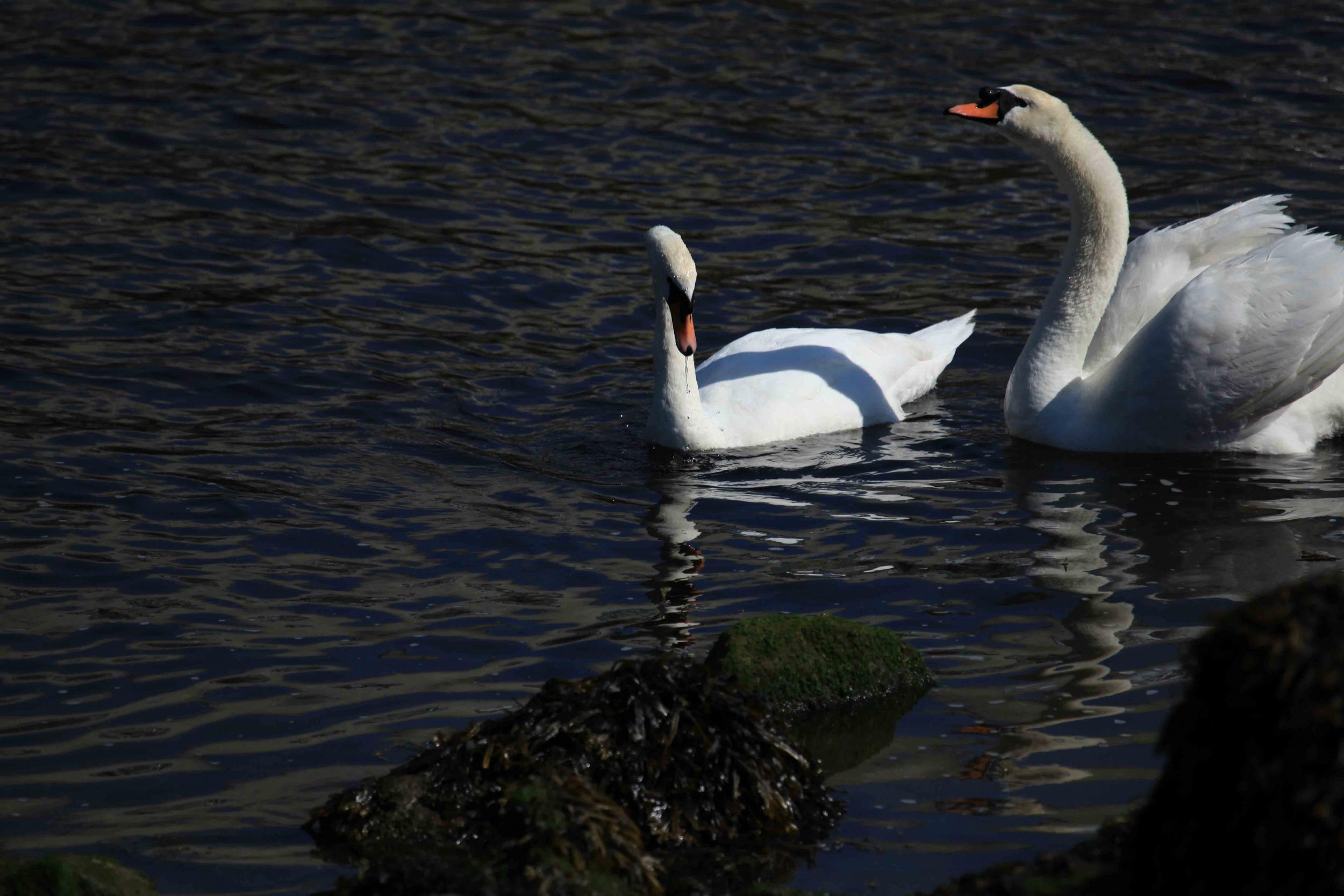

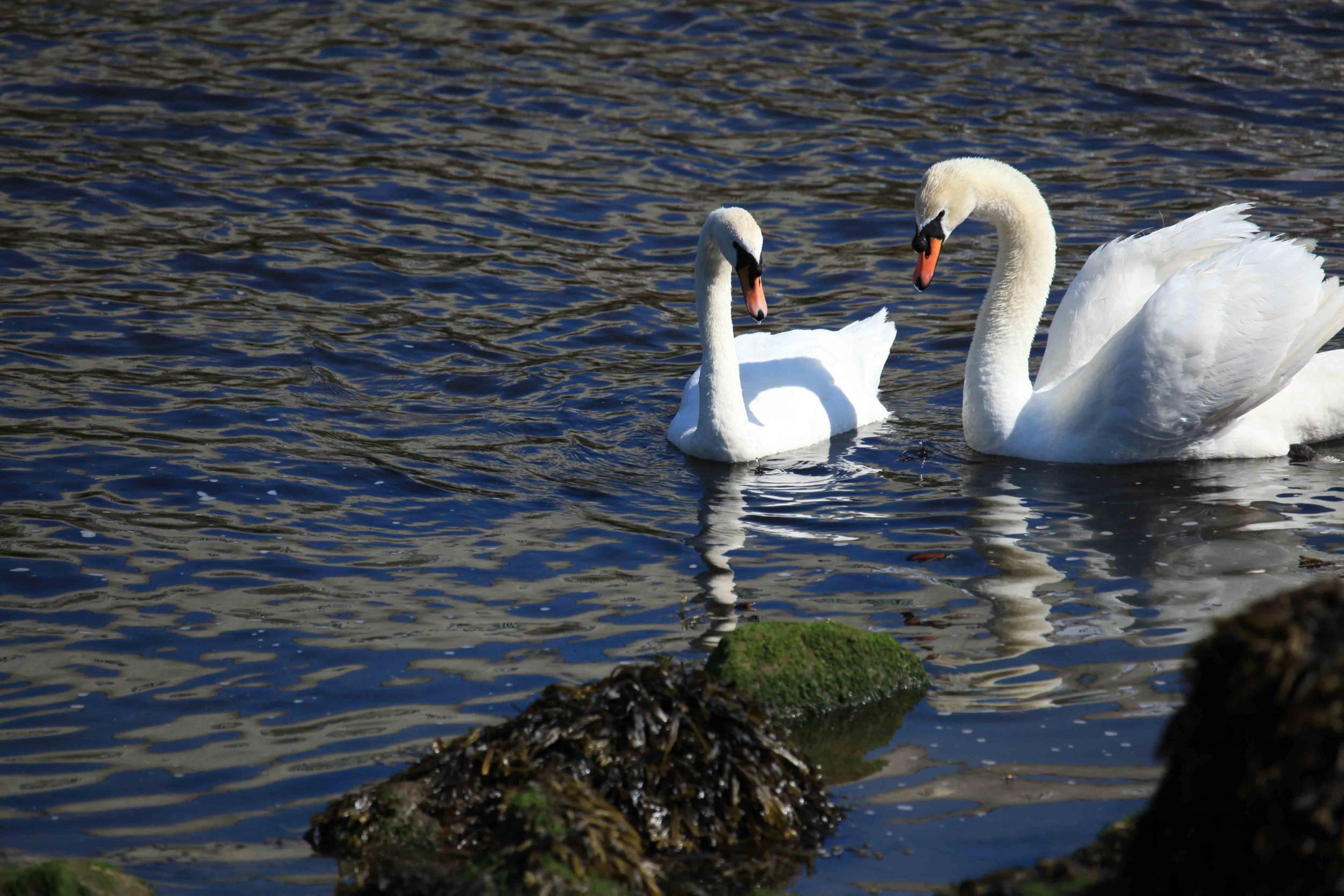

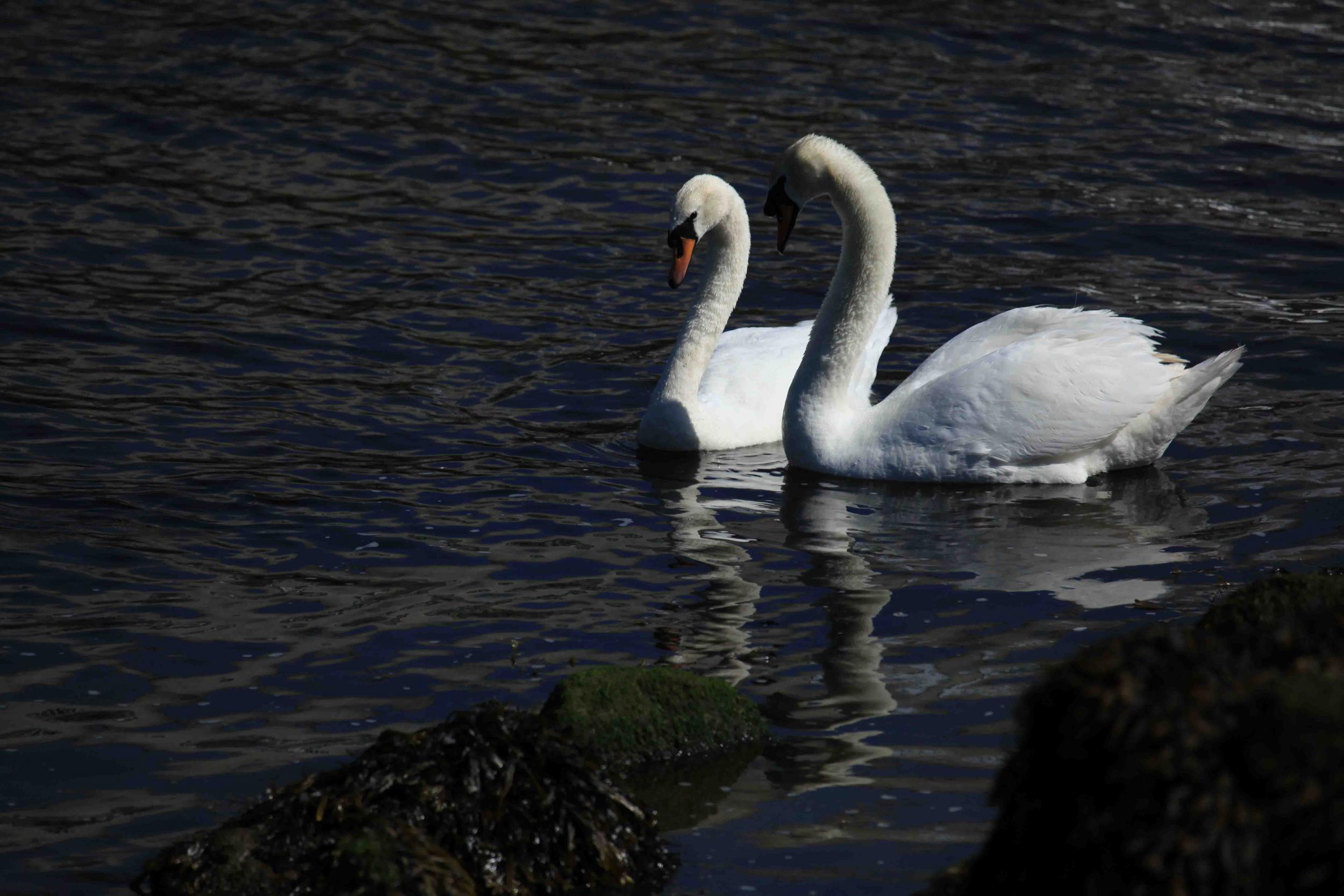

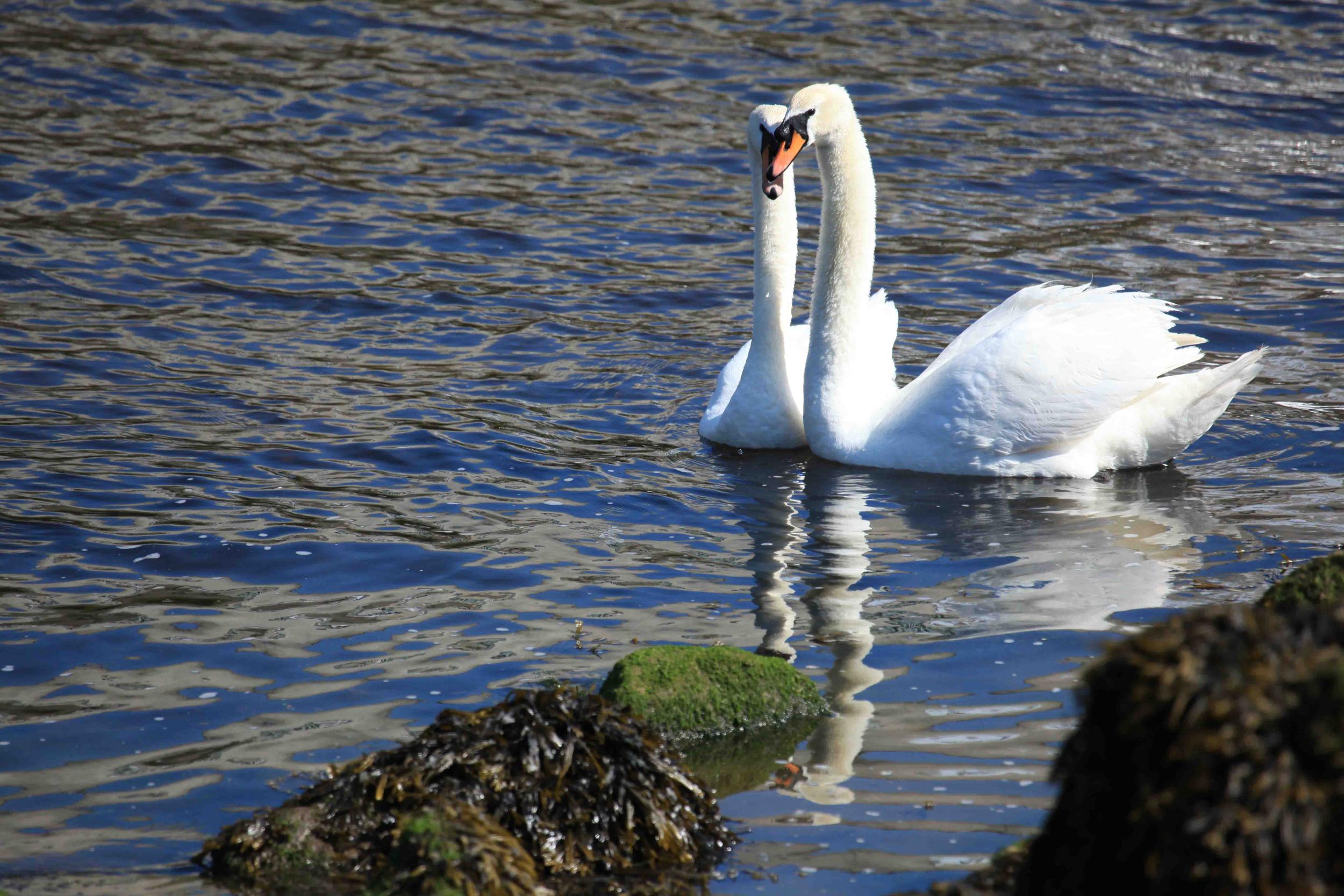

4 shots taken within 10 seconds; no light change. All @ AV and f/7.1; Spot Metering and ISO 400
1. 1/4000
2. 1/1600
3. 1/1000
4. 1/4000
Why did shutter speeds change and how do I get Mk II to optimize the scene, (by choosing #2 or #3 automatically like my 40D does in AV)?

If you used spot metering, then it isn't surprising that the exposure changed a bit between shots in a scene that contains a lot of contrast. In spot metering, just the small circle in the center of the viewfinder is used for metering.

Amn't I glad I asked the question and I thank you all for developing the question so that Pete could answer it. All my centre-focus-points were off the birds ... so that's when to think twice or more before spot-metering. Thank you very much, Pete. I wish I could have found that out for myself but, hopefully I'll know the next time.
