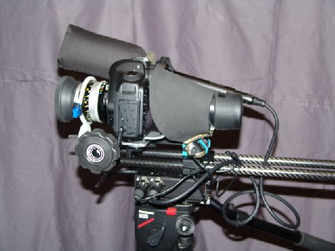

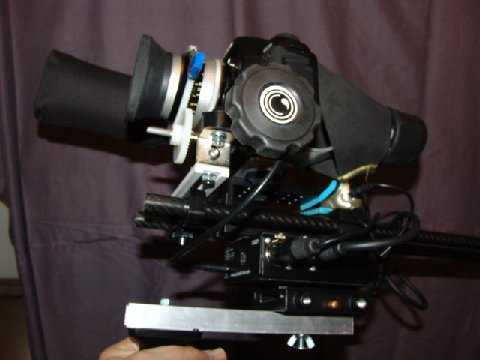

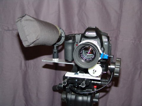

I have made my own follow focus before-- the friction type, using a common right angle drill attachment I got from Harbor freight for $20. That required some engineering with aluminum and such. And I could not make it fit with the 5D.
So I went to the DFocus product available for $ 100, or for $ 145 with 4 various gears sizes. The lens gears attach in a moments time, so there is no problem moving to a new lens. You select the right size, pinch it down and it self clamps on the lens. My hardest focus in lens is an older Nikon F 1.4, and it works fine on it.
D | FOCUS - Finally an Affordable Follow Focus Solution for Independent / Amateur / Hobbyist Film Makers!
This is basic rudimentary design of a fairly basic produce. Dave is producing these very cheaply. For my hardest focusing lens, I have had to torque down the set screws, and I hope that isn't an issue in the future. I think, from his Twitter notes, he is modifying gearing a bit. He also just added a marking disk. I am ordering one of those too. Also nice is the fact that he sells extra rod attachments that I will be able to add a shoulder brace to. Those are in shipment to me
I used a Studio4Productions rod support system for the setup shown in attached pics. The 2 items ran me about $ 300.00. I will keep all posted on how well things hold up.
Cheap follow focus for 5D mk2 under 150 $ wow-dsc08286.jpg   Cheap follow focus for 5D mk2 under 150 $ wow-dsc08281.jpg
