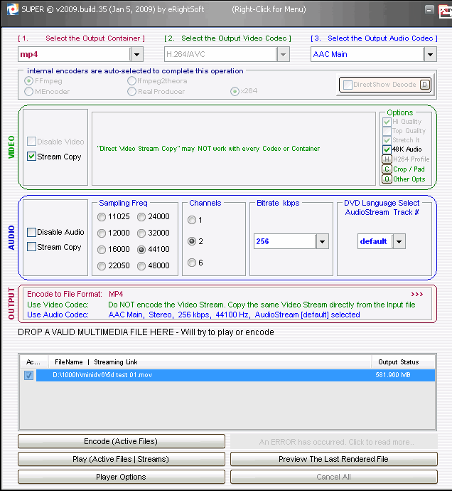

Steve, no problem. I think a lot of people are having issues editing 5D Mark II MOV files with Premiere CS4, whether on the Mac or PC version.
Re-wrapping the MOV files into MP4 is fairly quick (at least 20MB per second, equivalent to 4x real time of a 5MBytes/40MBits per second), even though it is another step. You are not transcoding the files -- you are not recompressing the files. So you will not lose quality, other than Premiere Pro clipping the RGB levels from 0-255 to 16-235. Steve, it's another step, but it is manageable.
So it's a decent solution (in addition) to using an intermediate codec like Cineform, or say Apple ProRes for Final Cut Pro. Transcoding to those intermediate codecs takes up additional time, and substantially more disk space, though the big benefit for those codecs are made for multi-generation workflows, color grading, etc.
Attached is a screenshot of SUPER re-wrapping a MOV file into MP4, but also transcoding the audio from the original uncompressed LPCM into AAC Main audio. (you can also do stream copy and write out to a separate WAV file)
1) Select Output container as mp4, outvideo codec as h.264/AVC
2) Select Stream Copy as it will not transcode the video, simply rewrapping the video
3) Right click, select Output File Save Management, and select a location
4) Drag your original 5D Mark II MOV file into the SUPER window
5) Hit Encode
