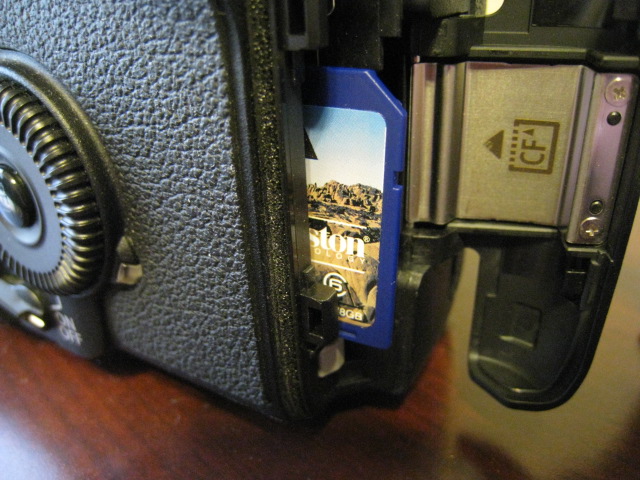

Old July 10th, 2009, 06:44 AM   #8
Posts: 27,382
Originally Posted by Nigel Barker View Post
multiple SD cards
I know you meant to say multiple CF cards, but it's important to make the correction for the benefit of other folks who may not be fully familiar with the 5D Mk. II.
Now I see my problem. No wonder the little buggers kept falling out the card slot:-)
Thanks for pulling me up for inaccuracy.

Old July 10th, 2009, 08:15 AM   #11
Posts: 27,382
Heh. "That rattle in your camera is normal, it's just the stabilizer mechanism sliding around."
Old July 11th, 2009, 11:17 AM   #12
Location: Allen, TX
Posts: 34
Lol. SDHC card firmware update please.
