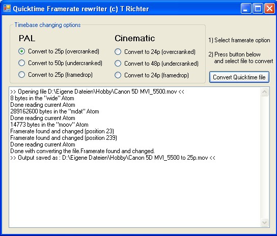

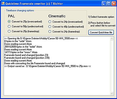

Results
Ryan,
thanks a lot for the clip.
Chris,
not quite. While trying to fix Tramm's broken mov clip I found where the framerate setting is stored inside the file. I would like to come back to your offer as I need a file with speech straight out of the cam.
My Results:
I did a few tests and built a really simple tool to change the timebase (see attached ZIP file and screenshot).
You choose overcranked 24p and 25p, undercranked 48p and 50p as well as simple 30p to 24p/25p conversion by frame dropping. The frame dropping is handled entirely by quicktime. The idea is you can pick for every clip which setting is best for dropping it into a 24p timeline.
For regular movements (e.g. cars driving), pick overcrank or undercrank depending whether you want it 20% slower or 60% faster. For tripod-shot talking heads, lip-synch or irregular movements just pick drop frames. The tool takes a few seconds to create the re-timed copy.
From my tests I have found that in original 5DII files the sound stays kind-of in synch. Unfortunately Ryans file is not a file straight out of the cam. In Ryan's file the synch just breaks.
PCs only for now, sorry Mac. Of course those with After Effects can change the timebase there, but maybe you still find this little tool helpful.
Warning: Early alpha - it works well on my PC but no warranty of any kind. Do not use on important clips yet.
Enjoy,
Thomas
Frame-rate adjustment: could someone please provide an original 5DII mov?-timebase-changing-tool-screenshot.jpg
Thomas Richter is offline   Reply With Quote

Old July 25th, 2009, 05:08 AM   #13
Join Date: Apr 2005
Location: Frankfurt, Germany
Posts: 181
Originally Posted by Nigel Barker View Post
If I understand correctly what this tool does then we Mac users can already do the same thing by conforming in Cinema Tools.
Nigel,
exactly right. I don't own a Mac, don't have Final Cut and I don't have After Effects. I was struggeling to change the timebase in the tools I had so I built my own. Maybe there are others in my situation that may find this helpful.
Thomas:
I took a 5 minute piece, ran it through and the sound track isn't even close. Not sure what is going on.
Chris,
thanks so much for the clips. It was late in Europe last night when I got them, so I only did some sound synch tests today. Undercranked means the sound goes totally out of synch, overcranked seems to work (at least in my workflow using TMPG Enc to re-encode into something editable). However, this means a pitch change that makes anyone sound like Mickey Mouse.
Framedropping again stays in synch for me but this may again be due to my workflow and not be true for others.
So for now this little tool is very limited framerate setting changer with no guarantee for synch audio.
Hope some may still find it useful.
Thomas
