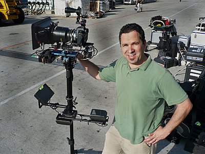

I can't reveal details of what we were using this rig on, but I thought you guys might like to see the MII all dressed up for use on a large-scale production. That's a Panavision Primo 35mm on front, with Preston remote and Cinetape horns on top, all perched on my lightweight "Nimblecam" rig. I also had my full-size rig with Millenium XL built adjacent to this as we were also shooting 35mm. We got amazing shots with this setup!

Whats that on the camera's LCD? Crop marks? :)

Yes, the feature is being released in 2:40. The 5D footage will be intercut with Super35 cropped to 2.40.
The 5D footage is being interpolated to 24 fps via Twixtor.

I'm not the DP on the show, just came in to do some operating.
The 5D allowed for a particular style of shooting on this project that would have been difficult or impossible with any other camera. It wasn't so much the low light capacity as the size of the system.

1. The monitor on my little rig is a modified Steadicam Flyer monitor. It's OK in daylight since it has decent anti-reflective coatings but it is just SD. Not a big deal with this camera since it only outputs SD when recording. I'm only concerned with framing so that's OK, but for those who need to pull focus off the monitor, there are higher res options out there.
2. Trick question! You can't purchase Panavision lenses so...! That is incidentally a 35mm Primo--gotta love its size relative to the camera.

OK, now that the information is out there regarding the helmet-cam setup some of you might have stumbled across on Engadget, I can divulge that this Steadicam setup was also used on the feature that Shane references in that article. We were out at sea shooting with this rig when the Engadget story broke which caused a bit of a flap as the helmet-cam was nominally proprietary. My Steadicam setup was less-so (we weren't the first to use PV lenses on the 5D, nor a 5D on a Steadicam) but Shane is doing amazing and groundbreaking work with this camera and I was honored to be part of the production.
The camera riser and Cinetape mount (off the hotshoe) were custom built by Panavision Hollywood to Shane's specs, plus there are some other off-the-shelf bits and pieces in there including a Bogen quick-release and Zacuto lens support.
