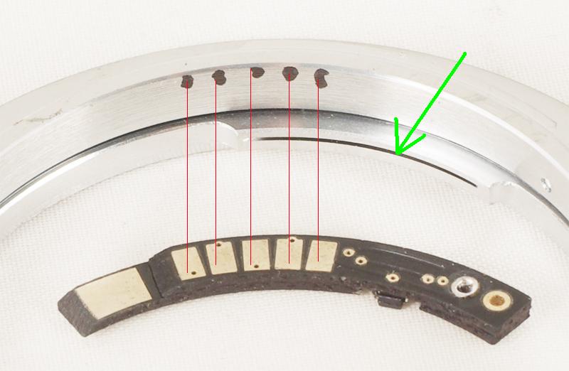

David, you might find that your 'cheap' adaptors for the Olympus lenses already have an expandable cut in them to improve the fit. To the best of my recollection there were two or three little split metal sections inside the adapter which could be gently expanded with a small screwdriver, trial and error fashion, to tighten the fit.
I'm attaching an image sent to me by my vendor with a green arrow indicating the split metal area used to improve the fit.

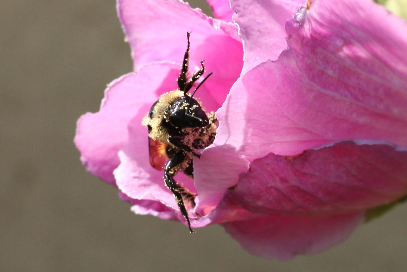

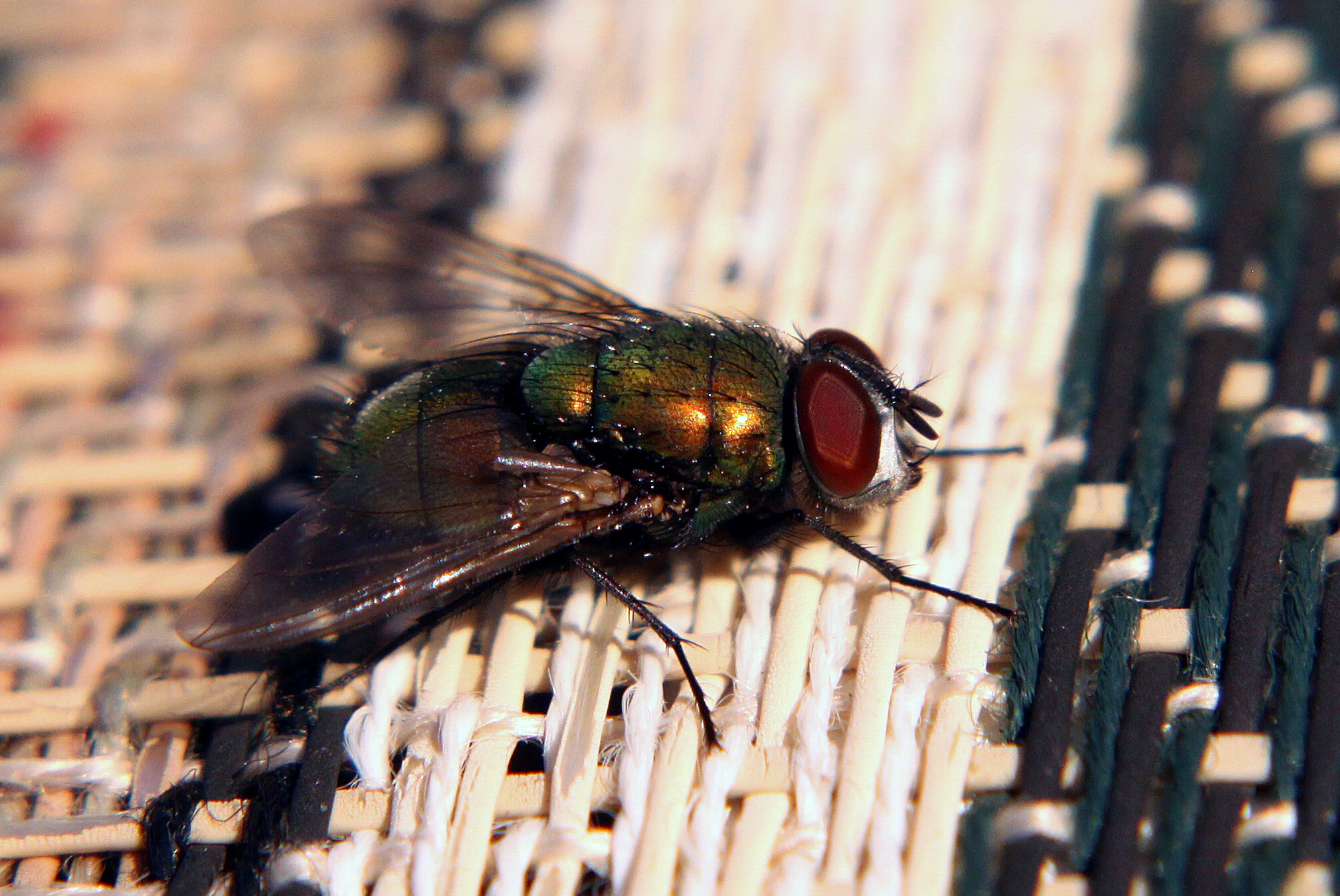

I finally got a chance to do some testing with the Photodiox adapter and the Mamiya 645 lenses and am quite shocked at the results! Just a refresher, I tested a 70mm 2.8, 80mm 2.8, and a 150mm 3.5. The 70 and the 150 are a little soft and I probably wouldn't use them for still photos, but work pretty well for video. The 80mm however is a different story all together! Super sharp at any aperture. It is even more sharp than my 50mm 1.4 (non L) Below is a 21mp shot through the 80mm that has been cropped at 100%. I just added another one shot with macro filters. The one of the fly is cropped to 66%. Both of these were shot without sticks.
All of the focus rings on these lenses are extremely smooth and virtually free of any noise. I will be using the 150mm primarily for a moderate telephoto for rack focuses as it is smoother and much easier to pull focus with than any of my Canon lenses. The Mamiya's have hard stops too woo hoo! Great for using with a follow focus.
I never thought that medium format lenses would fair so well on the 21mp 5DII.

Old August 26th, 2009, 10:14 PM   #10
Location: Denver Colorado
Posts: 28
Wow, Ryan, that looks amazing, what shutter speed? With out sticks did it have to be rather high?
Dutch Simpson is offline   Reply With Quote
Old August 27th, 2009, 07:39 AM   #11
Location: Highlands Ranch, CO
Posts: 336
Thanks Dutch! Yes the shutter speed was set fairly high on both of these shots. The bee was at 1/1250 and the fly at 1/800.
