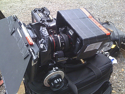

I shot using my two zooms a 24 -70 f2.8 & 70 - 200 f4 and mainly worked at between 100 to 640 iso. I shot at a 50th throughout & used the neutral picture style.

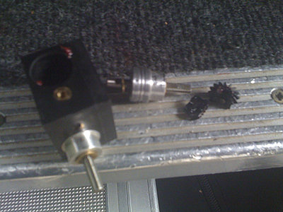

As for camera hardware I used a proaim bars & wedge plate system but because the proaim follow focus broke on the 1st morning ( nightmare & going to get money back hopefully!!!) I hired a Chroziel follow focus and matte box.
Filter wise I kept it simple by using a Schneider tru pol on most exteroirs and a ND.6 & also ND grads (.3,.6,.9 & 1.2) on skys when we needed them.
Monitoring was the biggest problem I used my Sony PVM9044 but mainly just for playback. Otherwise it was mainly just using a black drape over the top of the camera ( funny how with all this technology you end up going back to old methods). This monitoring solution was not the most popular solution by the other people in the crew. The sound recordist was most un happy ( aren't they always?)

Our Focus puller hated the Canon lenses as they do not stop rotating so we rigged up a G clamp and Noga arm system so we could stop the lens rotating. He still did distance checks at every opportunity.

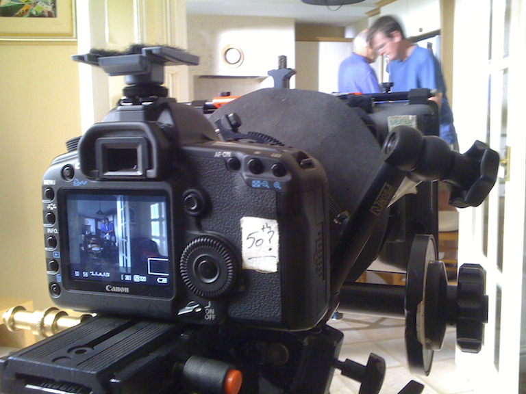

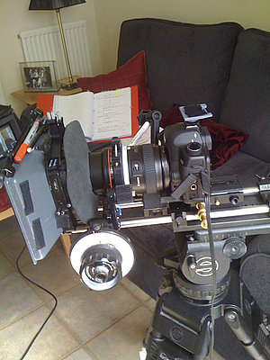

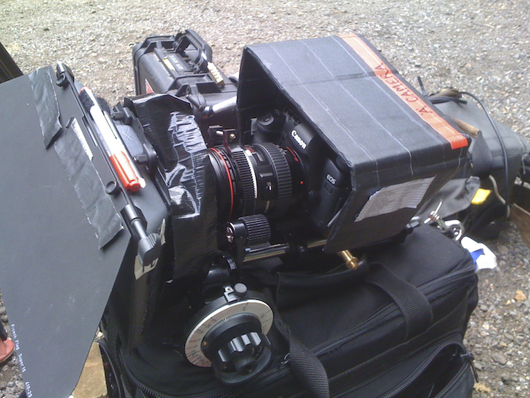

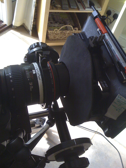

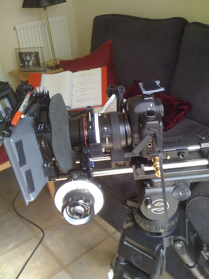

I have attached a couple of shots of the camera on location ( NO red rock or Zaccuto here!!!)

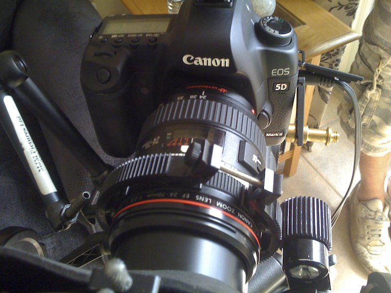

P.S: I have also included a shot of the broken Pro aim Follow focus gearing that snapped (PLASTIC GEARS!!)
Feature film just completed on 5d mk2-img_0249.jpg   Feature film just completed on 5d mk2-img_0248.jpg
Feature film just completed on 5d mk2-img_0246.jpg   Feature film just completed on 5d mk2-img_0243.jpg
Feature film just completed on 5d mk2-img_0250.jpg   Feature film just completed on 5d mk2-img_0236.jpg
