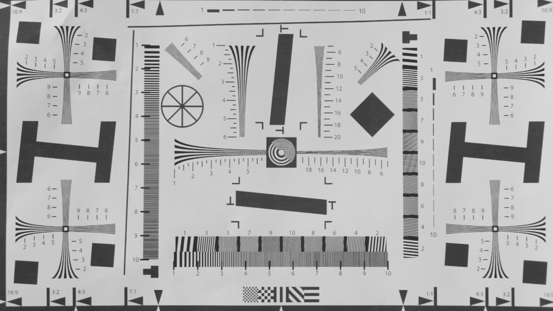

So I did some test shots here with a Chart that was printed off on my Brother Laser printer.
I shot using a superflat setting I downloaded from another shooter. I am curious what you expert readers make of the resolution chart shooting this way. I did one from a color corrected grab off of vegas (cause I didn't set camera to daylight) and one of same frame with saturation all the way down to zero. Be interested to know what you read these at.

I'm viewing your screen grab from a Blackberry at actual size, a bit of a joke but nevertheless, I read the vertical and horizontal resolution to be about 700 lines, not a bad performance, and a little better than I tested on mine. That's definitely HD territory, the issue for me with my 5D has always been the aliasing, not the rez.
700 lines is particularly pretty decent since it maintains it in the corners/borders.

I shot this with a Takumar Nikon mount 28-85mm lens, in Macro mode, somewhere around F5.6 to F8. I don't know if that makes a difference. But I assumed that filing the frame is what is important.

Actually looks better than that now I can see it on a proper monitor, maybe closer to 800 lines in both vertical and horizontal. Everybody that does a test is going to come up with a different number, it's really only relevant when you can compare what you get with other cams under the exact same conditions.
When I tested my 5DMkII with a 50mm prime, I remember around 650 lines horizontal and 750 vertical, but in comparison, it lagged a bit behind the HV10, XH-A1 and a distant stretch from the EX1 under the same conditions. Regardless, the numbers are solidly Hi-Def, no question, and no surprise we see such great videos from the 5DMkII.
(It also comes with a stellar still picture cam at no extra charge!)
