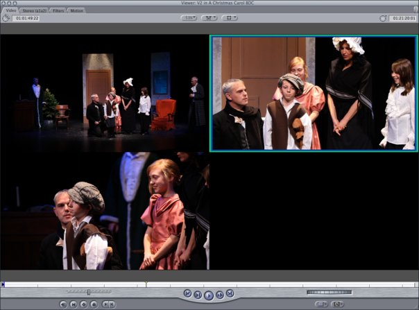

With all the complications I'd just point it at the concert personally. I've recorded plays like this and it's not perfect but it's ok for a decent copy, a record of events.
I've also been getting away with 50 at f8 and ISO at 1250 which is quite a good result. I always use ISOs of 160, 320, 640 or 1250 because I read somewhere on here that those settings keep the noise down.
This was a milticam screen grab from two 5D2s and a 7D from a couple of weeks ago at those settings and you can see there's plenty of light.
