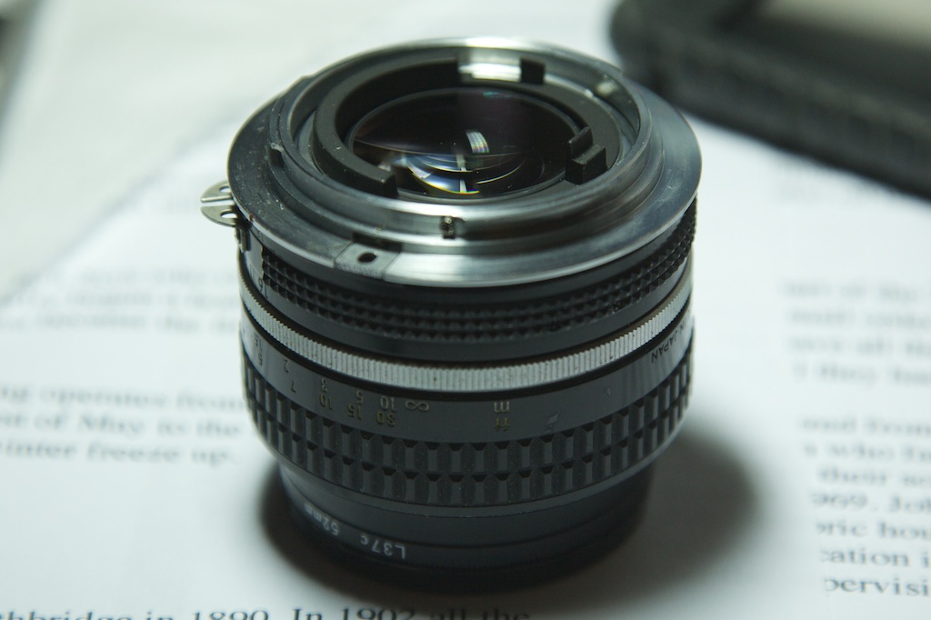

Does anyone know if this lens will work with the 5Dmk2?
It's a non-Ai Nikon 50mm 1.4. Serial number 3940124.
There's a lug sticking out of the end that goes into the camera. I keep reading about snipping these off with tinsnips but this seems more substantial than that.
Enclosed photo shows lens with Nikon-Canon Eos adaptor attached.
I couldn't make much sense of any of the posts that I could find on the web relating to the use of non-Ai Nikon lens with the 5Dmk2 so I thought I buy one and try.
If I insert the lens and twist it comes up against solid resistance very quickly
Do I need to cut this lug off with a hacksaw?
Anyone with experience of using this lens who can offer advice - I'd really appreciate hearing from you.
Thanks.

Will this non-Ai Nikon lens will work with the Canon 5dmk2?-non-ai-lens-50mm-1.png

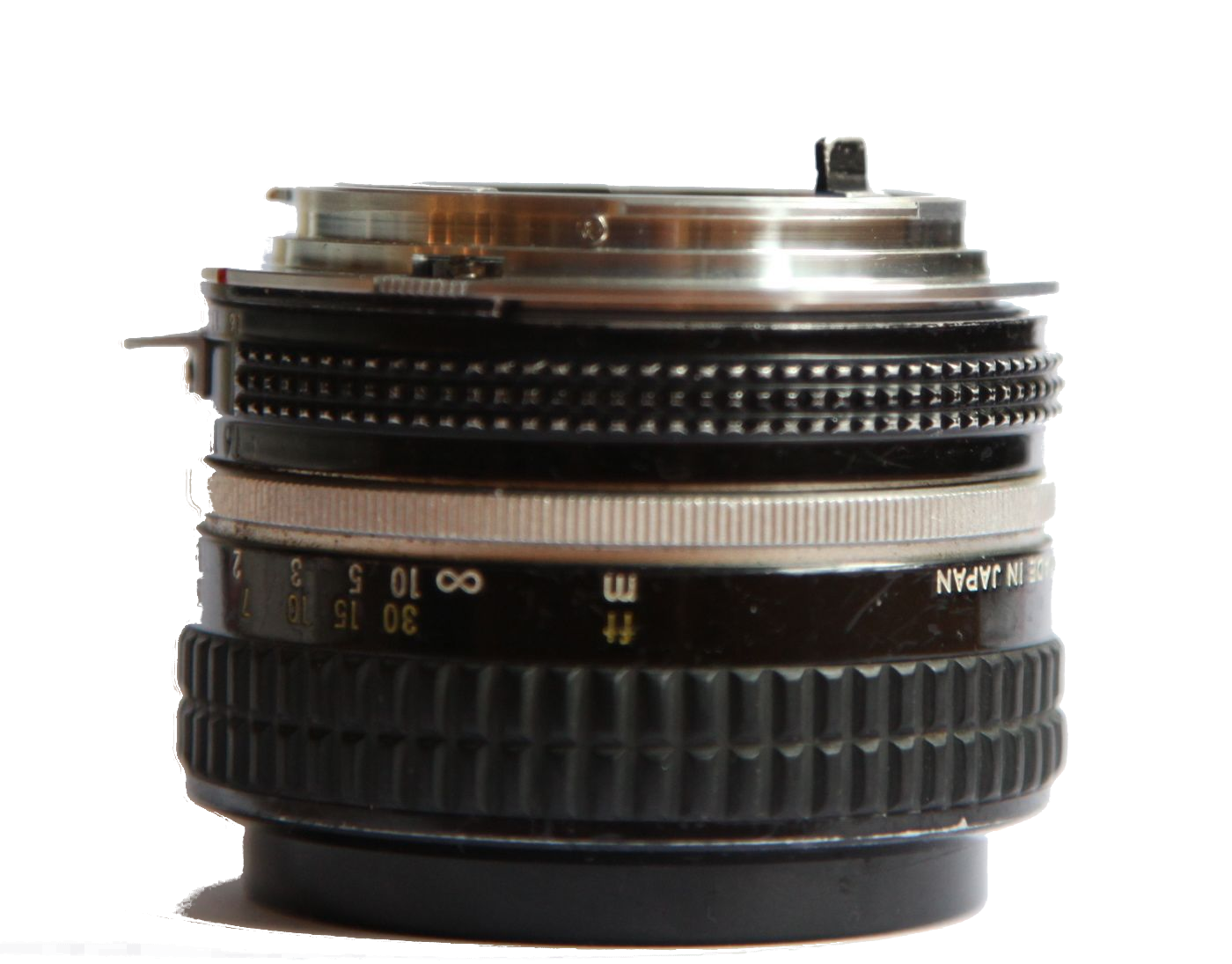

Yes mine has the same lug. But it mounts on the camera with no resistance at all. Just a nice smooth movement until it locks on.
Will this non-Ai Nikon lens will work with the Canon 5dmk2?-img_2928-version-2.jpg

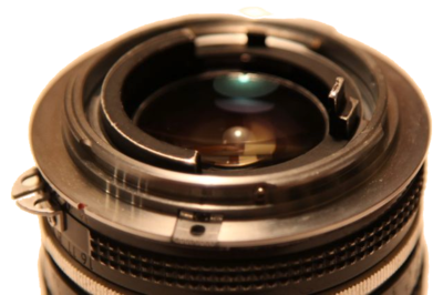

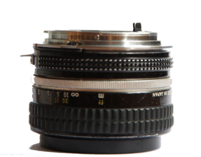

Morton or Nigel - I enclose a side view. Can I ask if the lug on your lens protrudes as far into the camera as this one does?
Will this non-Ai Nikon lens will work with the Canon 5dmk2?-lens-side-view.png

Hi Richard,
Hard to say from the photo if it sticks up further. On my lens is 6mm from the base to the top of the tab and it is about 3 mm above the Canon Lens mount adaptor. Hope this helps you out. I don't suppose you have another adaptor you could try. Perhaps that is the problem.

I think that this lug is fouling the black plastic part inside the camera that has the brass connectors mounted on it ie at the bottom of the camera when you look into it with no lens in place.
It comes up hard against it as far as I can see.
I've got four Ai lenses using the same adaptors and they work fine. I've tried swapping the adaptors over but it makes no difference.
Looks like I will have to cut the lug off.

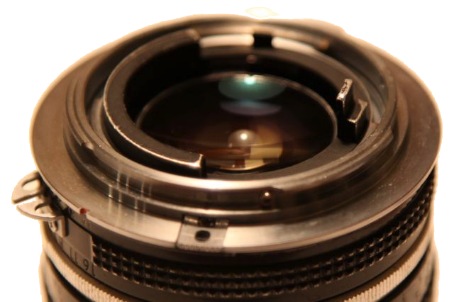

The metal is so soft on those I was able to cut mine, carefully, with some metal snips pinching either side and then twisting the little remaining off. At least I think this is how I did it since I did it a few years ago. I might have been able to cut all the way through it in one cut, can't remember. I recommend snips though, if you have the proper sort, better that way then taking a saw to it and dealing with the filings that will be created.

Thanks for the tip Christopher.
I snipped the lug off and the lens now fits.
