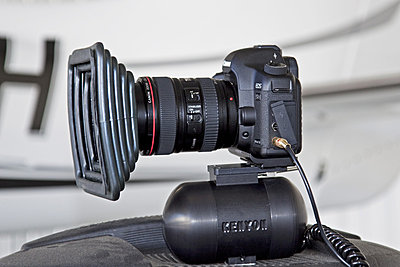

That's for sure. In my case a lot of what I shoot is through plexiglas and I've tried lots of things to eliminate the glare. The best solution I've found is to use a soft bellows made from cutting up a truck shift boot from Pep Boys. This is soft enough you can press it against the plexiglas to block the glare, and flexible enough it doesn't transmit vibration.

I like your pep boys idea. Have you seen the rubber lens hood on ebay? I have used them. They collapse nicely, are inexpensive and do the job. I use variable ND filters and the rubber lens hood screws onto it. It acts as a hood but also allows a larger surface for adjusting the filter. These hoods are not real stiff. Your opinion.
kent

Kent, I'll try one. I need to go very wide angle now and then but it looks these hoods slip back to a wide angle position. Thanks, Chuck
