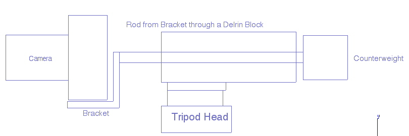

Here is a very simple system I have used before.
It is made from a piece of aluminum L that is attached to the bottom of the Camera.
It has a 1/2" rod that comes out the back and runs through a block of Delrin plastic (very smooth turning w/o bearings) it has a counter weight in the back to balance on the tripod head.
The Delrin Block has tapped holes for mounting on your tripod head.
This works very smoothly you can even add a crank on the rod outside the counter weight.
If you are handy you can easily make this.
If not contact me and I will quote you a price for one.
olof@westsideav.com
603.383.9283

Hi Olof,
I like your assembly. one thing to consider when designing a roll-over mount is how to monitor the picture.
The rental model I used had a tube through the middle (for a video cable) and a take-up spool so that you could pre-wind several revolutions and then unwind it during the take. You could probably feed audio too... (yes you could use wireless instead etc etc.).
The design differed from yours in that the camera/roll-over mount assembly's centre of gravity was directly above the tripod/head and it had a car steering wheel (Renault I believe) as the means of turning. Therefore it didn't need a counterweight.
It was crude but effective - it even worked pointing straight down with the Camera Operator using his foot to turn it.
best of luck
Paul Kousoulides is offline   Reply With Quote

olof
thats what i was thinking, except for the delrin block, thanks for that.

I do use a tube in my old design actually for that very reason.
I also have a way of balancing the rig so it is neutral. This is important for fast spins, or it will wobble.
It is also a very nice rig to use on a dolly doing dutch rolls to simulate dizziness. It is more intense than doing this with a steadicam.
And it works well straight up or down as well as anywhere in between.

Hey, thanks guys. Great info.
Olof, I'm going to give that design a try. I'll let you know how it turns out.
