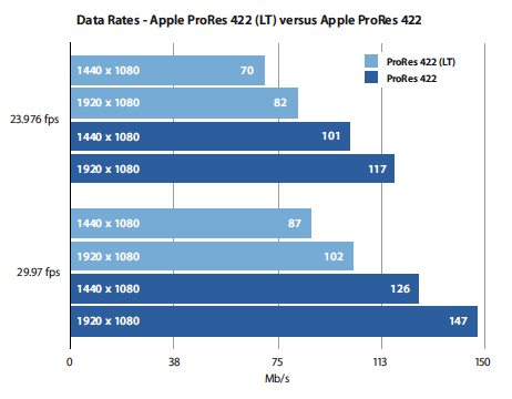

For 23.98 @ 1920:
ProRes 422 is 101 Mb/s
ProRes 422 (LT) will be 82 Mb/s
I've attached a comparison chart from the whitepaper.
Your 7D should average 45-48 Mb/s (not to be confused with MB/s).
Now on to the savings: If you are going to have massive SFX, green screen or heavy grading, you'll benefit from a higher data rate (ie Standard or HQ), although the camera already has a hard limit on the data stream- so essentially, LT's data rate is overkill.
