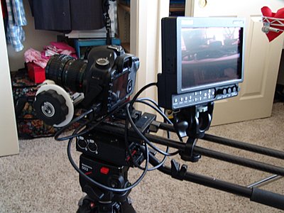

They have you order a battery mount of choice. I had a lot of Sony L batteries for my VX2000 and FX1, so I ordered that. I haven't ordered any other accesories. I mounted it to my rails sytem with an extra rail block I had bought it sits on a Manfrotto swivel I had for my monopod. Should work great, even when I attach my shoulder mount behind it. See pic attached.
