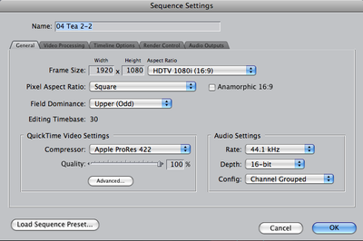

Do you mean that Final Cut defaults to sequence settings that seem "interlaced"? It would be helpful if you'd post a cap of your sequence settings. For example, this is I think pretty standard for a 5D Mark II timeline, with Frame Size set to HDTV 1080i and Field Dominance set to Upper.

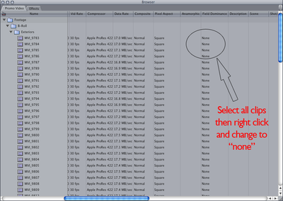

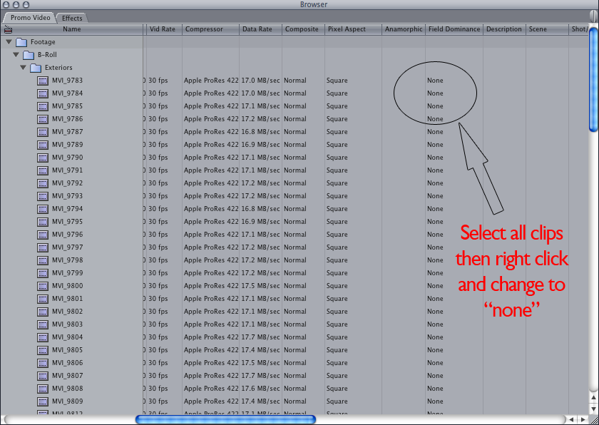

In the browser window itself, select all the clips to be changed and then find the "field dominance" row in the browser and then right click and change to "none". This will change all clips simultaneously.
