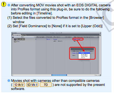

I believe there is a note in the quick start instructions that says to select the newly converted files and change "upper field" to "none" after importing.

Here it is from the .pdf Quick Start download:
