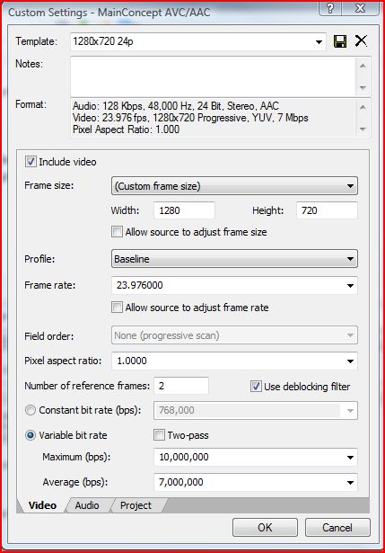

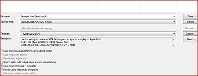

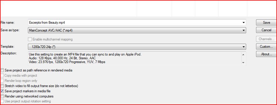

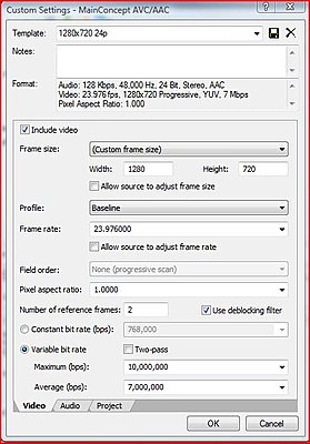

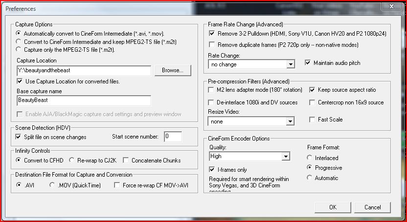

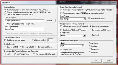

Harry, what version of Cineform are you using ?
My version of NeoHD does not have the exact choices you reference. See image below for my Cineform selection for Canon 24p from 5D Mark II.
However, I wonder if you inadvertantly have the Mp4 output set at interlaced ? It should also be rendered progressive. I ve also attached screen grabs of how I set up the MP4 render.
