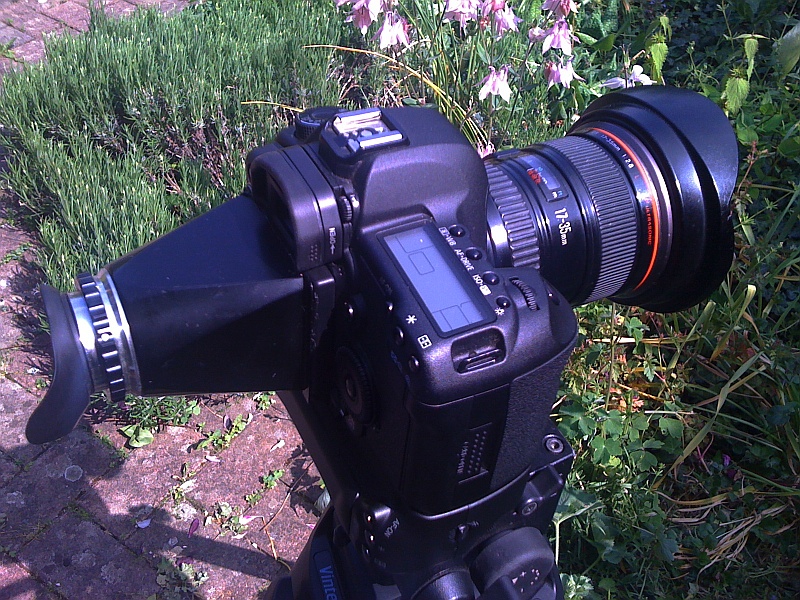

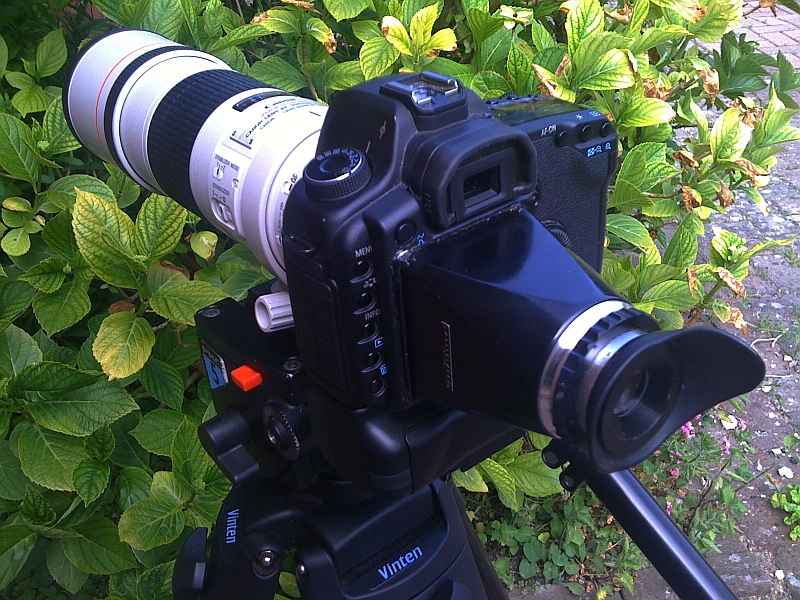

Mitchell, here are some 'quick & dirty' pics taken on my iphone, so sorry about the quality:

Nice! I was thinking that you had a mirrored type viewfinder so that you could stand over the camera and shoot (for low angels)

No Mitchell, when I need to view from above or very low angles or from a distance etc, I use the Phottix Hector Live-View Remote:
Phottix Hector Live-view remote - Wired remotes
