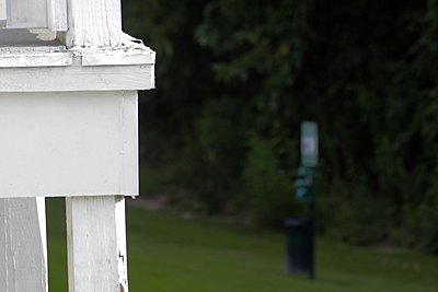

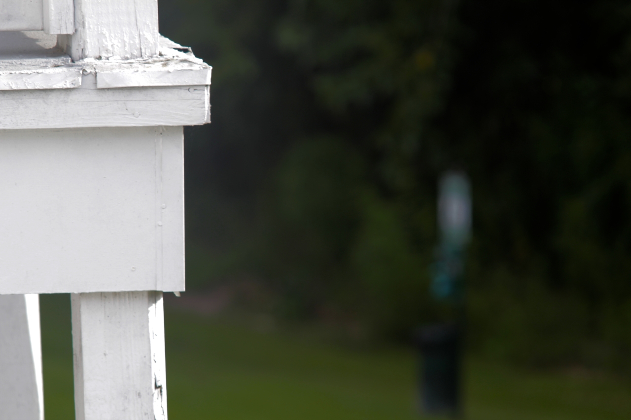

Well, for instance... my T2i kit lens (18-55mm) has a focus throw of about 70 degrees to go from full close to full wide. My Nikkor H 300mm prime is about 170 degrees to go from 13ft to infinity. That piece of glass is from about 1972 or thereabouts. Autofocus would take a week trying to move that far. In fact, it's 70 degree throw is 13ft to about 35ft.
[Edit]
For grins, I mounted the Nikkor onto my T2i, and took a shot. Then I mounted a more modern Sigma zoom (both say they are 300mm glass but....) and took a similar photo. The difference is striking. But exactly what I'd expect, and exactly what I wanted.

My old classic Carl Zeiss 55mm f/1.4 has a very long & smooth throw (that isn't backwards either), and its DOF & bouquet is just beautiful. Other fast and long-throwing lenses worth looking into are the f/1.1 Voigtlanders.
Yea, your Canon DOF is definitely shallower, and it also seems like there's a focal length difference (unless you were standing on different spots while shooting). Would be nice if there were some colors in there, to see the bouquet differences.
-- peer
There is a focal length difference. The tripod never moved. So either the Nikon is longer than 300mm or the Canon is shorter. There is some halatation in the single coated Nikon but that's expected and desired. If I wanted razor sharp glass I'd be buying new L lenses or ED glass.
