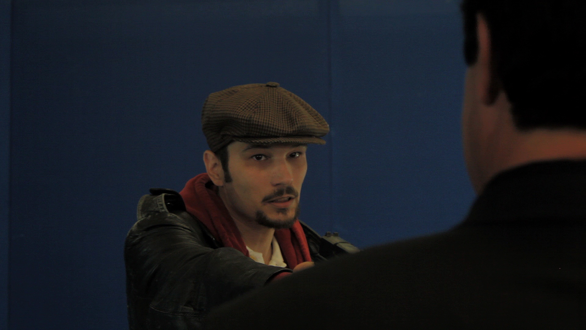

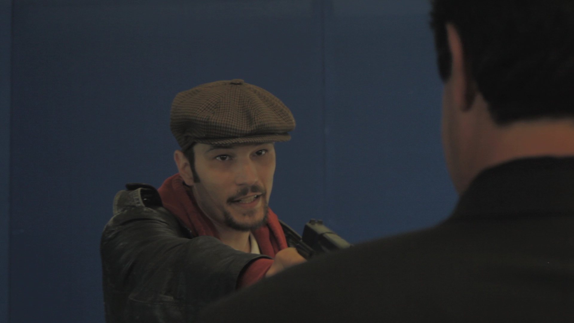

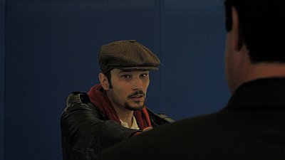

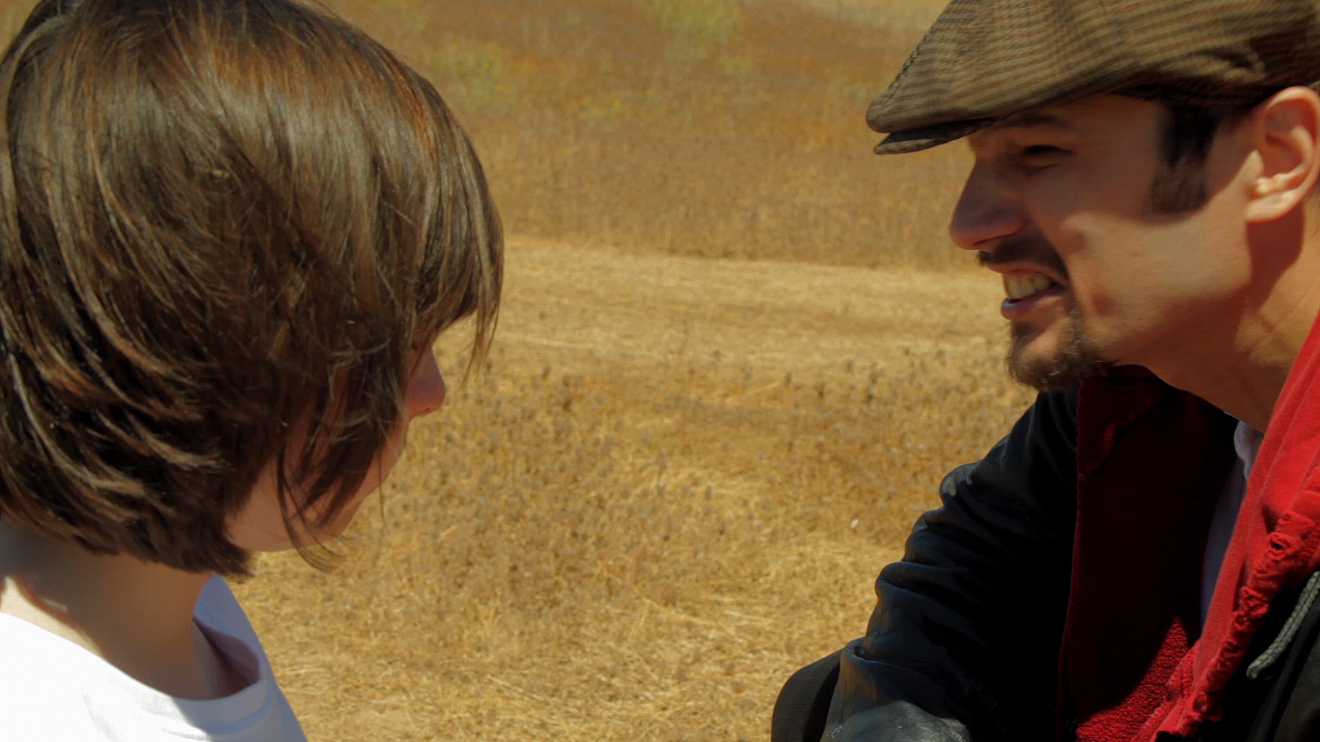

I am attaching two examples of before and after from two scenes in the last film I shot... an entry into the Canon Beyond the Still Competition.

Chris J. Barcellos
