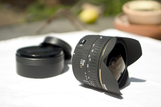

The best cheap & wide lens I've had -- Sigma 15 mm f2.8 EX:
5d Video shooting and shutter speeds and wide angle lens recommendation-sigma-15mm.jpg
