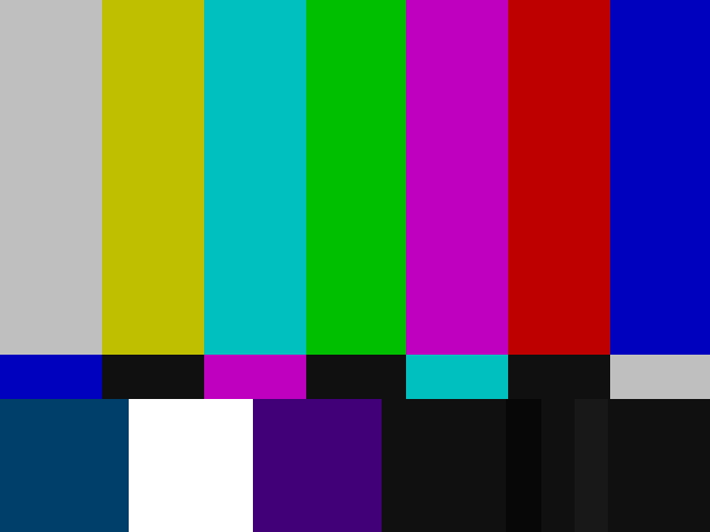

have you tried loading a smpte color bar jpeg to your cf card then "playing" it back from the 5D to your liliput?
I have saved color bars on each of my cf cards for this purpose.

Ted
Where'd you find the color bar charts for the 5D Mk2? I found some but when transfering to the CF card and tying to view in the camera I see a graphic ? mark where the color bar should be. I shoot RAW is there a RAW color bar chart to be had?
Nashville TN using Canon 5D MK3, Canon 550D, RODE SVM mic, 70-200 f2.8L II IS, 24-105 f4L IS, 50 and 85 f/1.8, Vegas Pro 11, Zoom H4n, Blackbird, Lilliput Monitor, Lightroom
Harry Simpson is offline   Reply With Quote
Old April 1st, 2011, 12:38 PM   #9
Location: Allen, Texas U.S.A
Posts: 1,117
Re: Canon 5D and Lilliput Brightness
Try to download this file I'm attaching.
Right click and "save image as"
Its the same file I place on my CF cards.
I use it on my 7D so I'm not yet sure if its gonna work on a 5D. I think it will.
Use a card reader to transfer it into the folder containing images in your cf card.
Say if it still won't open so I can email it to you.
Ted
