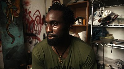

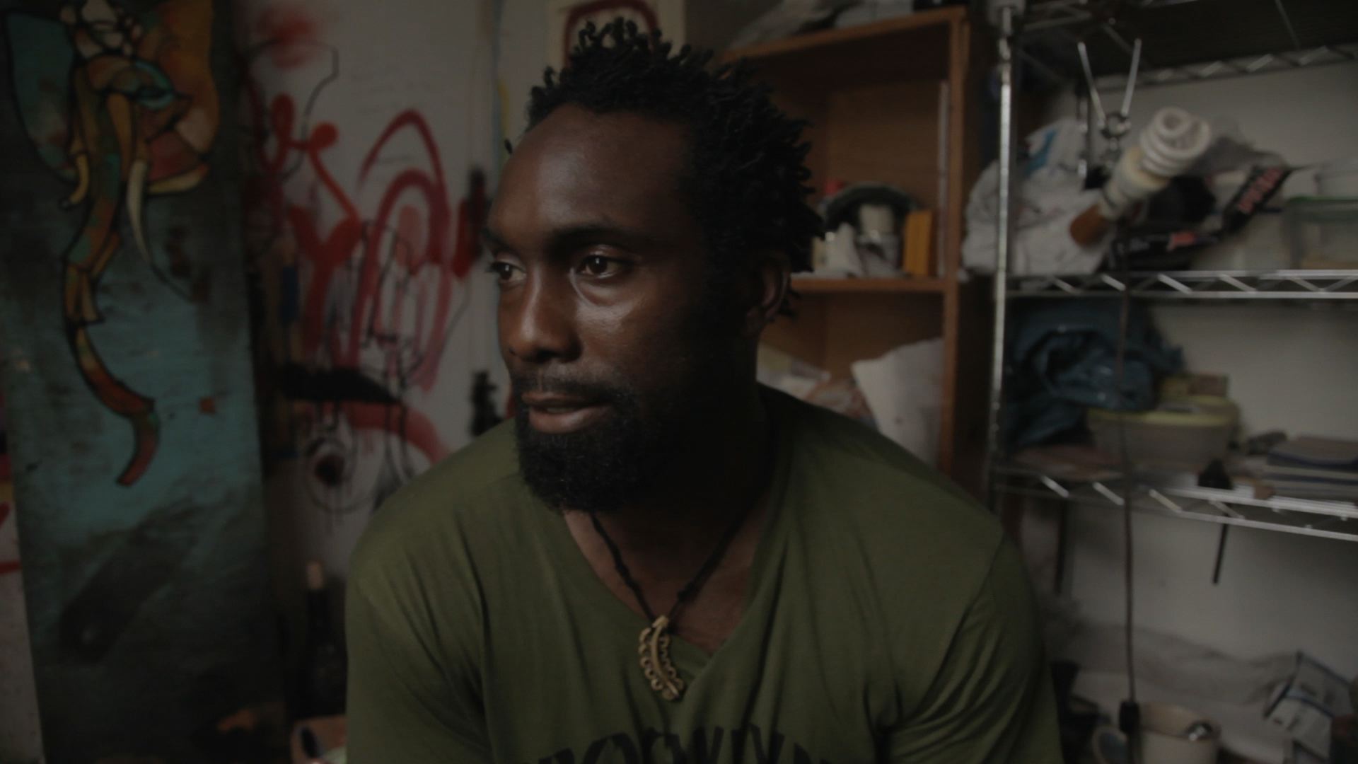

5D Mark II, Technicolor cinestyle and heavy color grading
The Technicolor Cinestyle has enabled me to do far more color grading than I was able to do in the past with DSLRs. I recently shot an episode of a Crossing Dumbo, a web series that I created. We used Magic Bullet & FCP 3 way color correction. In Magic Bullet we used up to 6 filters to obtain the bloom in the highlights that we desired. I really enjoy the new latitude that the new Cinestyle gives, in the past the blacks were far to crushed to do much with. I still feel that I am limited on how far I can grade before losing to much information in the image. Has anyone been doing heavy color grading with the new Cinestyle, I would like to hear your thoughts on it?
The rest of the series can be seen at the link below
Dumbo NYC, Brooklyn Crossing Dumbo (DumboNYC.com)
I used a 5D mark II with a 24-105mm F4 L & 14mm F 2.8 L & a 60D as B camera with 50mm F1.2 L with no rigs.
I have attached a before & after color correction images
On a music video for the Dirty Pearls we just premiered last week. We used an XBox Kinect along with the Canon 5D Mark II. The close ups were shot with 5D Mark II with heavy F/X used. Again the amount of detail that we retained using the Technicolor Cinestyle really helped with layers of F/X used.
The post was done FCP & Adobe After Effects
Link to video. Best viewed in HD

Did you shoot -4 contrast? I only ask because I wonder if shooting with such low contrast and cinestyle indoors is something that you see as being useful. Having seen a bunch of tests and done some of my own I have mentally filed cinestyle (combined with -4 contrast) as a setting that I would only use in bright daylight conditions.

On my monitor, at least, there seems to be a difference in gamma between wider shots and closeup shots. Gamma seems to be a bit high to high on the closes ups giving a bit of a washout feel.

To answer Ben's question, I definitely find Cinestyle useful for interiors to keep the blacks from crushing on capture. I don't tend towards the crushed look anyway (as given in David's examples here) so I'd rather have the extra latitude in the shadows to play with. After years of having the extra room in the toe that HD afforded, it has been tough to lose it with the DSLR's and Cinestyle gives it back.
As far as pushing color correction to an extreme, I think we all know that the codec is somewhat thin. I haven't had much trouble with it but again, my version of pushing things in post is probably less than most people's as I generally lean to a less affected look.
David, it seems slightly ironic to me that you are using your series as an example of what Cinestyle does for you when your CC is so contrasty--even in your camera original, you are lighting to high contrast and then cranking it the rest of the way in the grade. I'm not so much commenting on the results, but just what it is meant to illustrate.

Hello Charles, thanks for your thoughts. So do you always shoot with -4 contrast with cinestyle or do you dial in different contrast settings? I haven't done the testing but I have a suspicion that even with slightly higher contrast cinestyle still won't crush the blacks. The reason I ask is because I've noticed that in situations where the lighting is very even the extra latitude can be more hindrance than help, given the limits in being able to push the codec in CC.
Re your general point on crushed blacks. I think this is interesting because it has become a kind of default look that people add to their footage in CC. I have seen only a couple of examples of a far less aggressive contrast curve achieved with cinestyle and have thought that the look is something that would be totally appropriate for various kinds of subject matter. Documentary is one that comes to mind, but it also has a kind of classic film feel that I really like. If you have any examples of that look that you can share that would be great.
