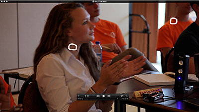

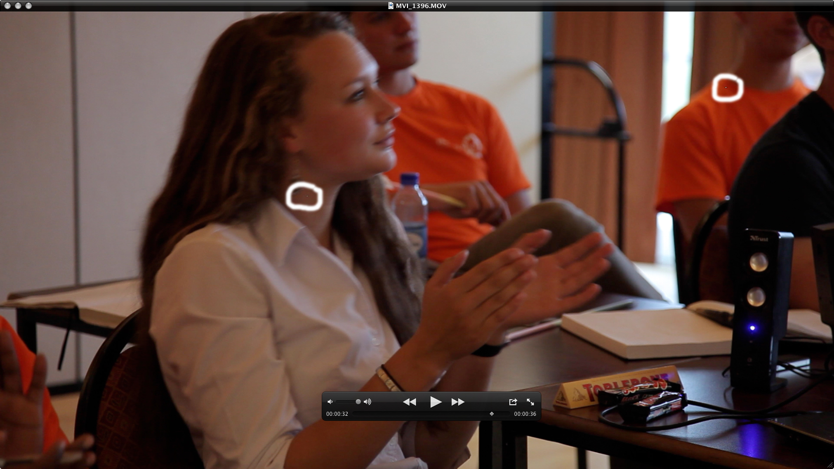

I've been shooting happily with my 5D for a couple of years, but I now have two collections of dead pixels whilst in video mode (please see attached photo)!!
The dead pixels are not immediately obvious, but once the camera has been running for more than five minutes and heated up, or been used at high ISO's they become very noticeable.
