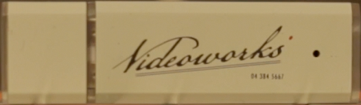

Thanks Andy/Markus,

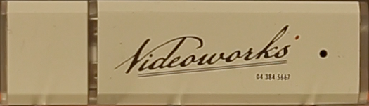

Yes Jon, my thoughts are the 5d2 resolves no more real detail, but the aliasing sure makes it look sharper.
Here's a couple of quick (actual size) screen grabs of a usb stick on my desk. The soft one is with the 5d3 at sharpening and contrast both at 0 (where I would usually set them on the 5d2).
The sharper image is with contrast two notches up and sharpening at 3 (of 7). Big difference! So you can dial in sharpness much more to taste with the 5d3... or shoot soft and crank it up in post.
