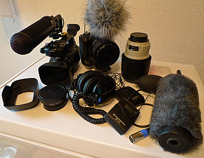

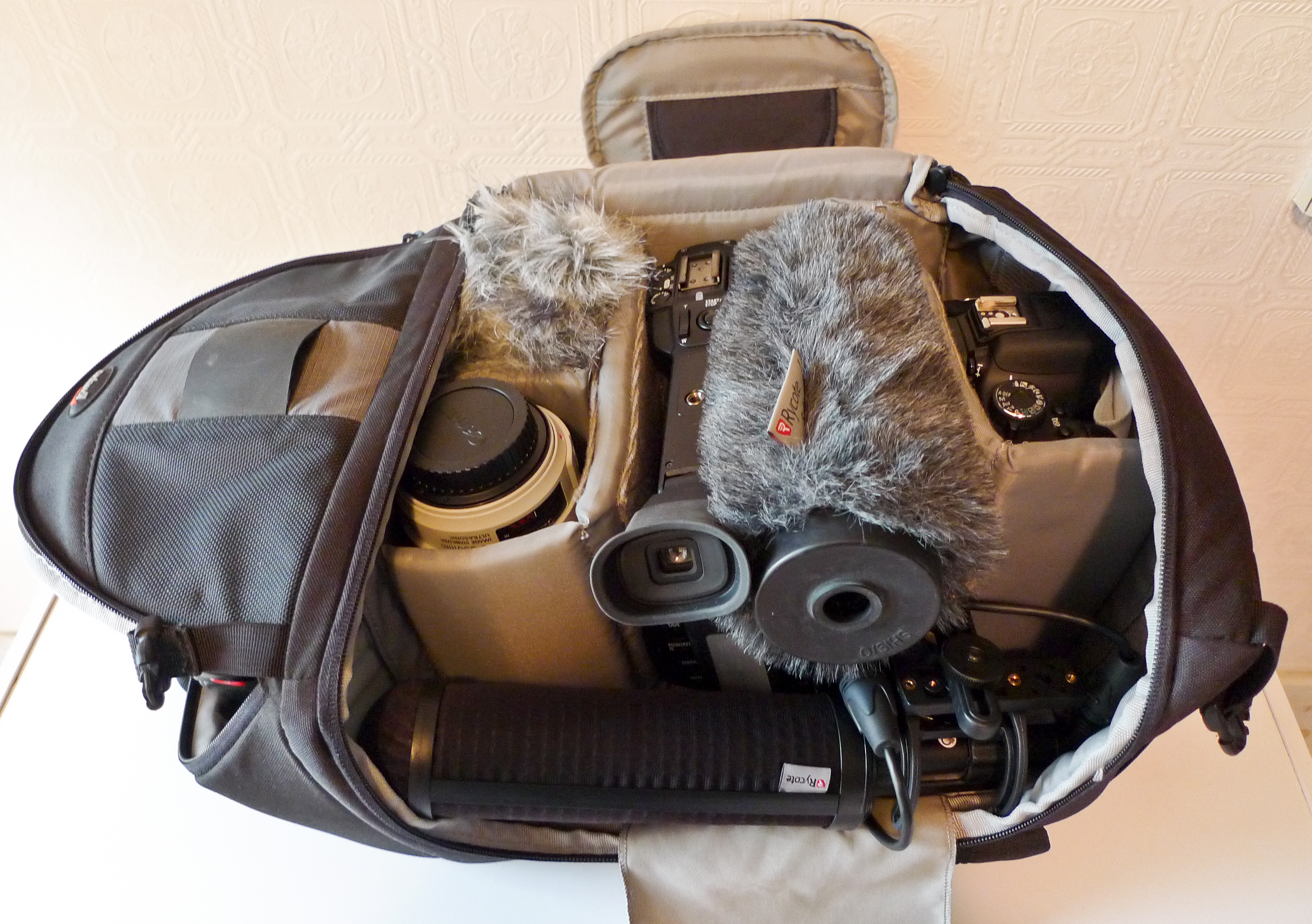

I know I said I wasn’t going to say any more but somebody has to think about the birds!!
The most important thing that you must consider is what John said “It depends what you want to do” You did say birds didn’t you? When I think birds I want all the magnification I can beg borrow or steal and still make it look good. Going off on this excursion with 200mm max on a full frame camera with a subject matter of birds? I don’t think so….Everybody that thinks this 5d set-up that is being bantered about is the best tool for THIS job raise your hand.
Oh yes, rainy season in the tropics. I can’t imagine the Glad-bag set-up necessary for a rain cover on the 5Diii/200mm 2.8 lens/monitor/audio and all the wires necessary to make that work. The term “handy” doesn’t spring to mind.
But could somebody PLEASE post a photo anyway of a similar rig with rain cover attached where you can view the monitor and operate the controls? Can I get an AMEN to putting that idea to bed brother?! The two times I had my “Cinema Rig” out in the rain an assistant held the rain cover, it was large, looked kind of like an umbrella and said Titleist on it.
Part of the problem is you pretty much already decided the 5d was the way you wanted to go for whatever reason and now what’s happening is everyone is trying to help shoehorn that into a kit for your daughter.
Now I must confess I am the biggest equipment junkie going and for some reason if it has Canon on it I have some deep seated NEED to own it. I have owned every type Canon video camera produced in the last 20+ years except the C300 (and it’s early yet) and I have two ex wives who will sign an affidavit supporting that fact. And since I first started out as a photographer, my addiction to lenses and bodies is worse than video cameras. Yes I need help but so do others on here.
So I guess I want you to think like this: You’re at the Canon store and you can pick whatever you want, price be damned. Almost every day you will be filming something, you’re not exactly sure what, but you need to be ready. Now you need to carry this daily, through the woods, on a boat, up a tree, in and out of your car, rain, snow, sleet or hail.
The first day out you jam that bag so full of stuff, you get another bag. Hell, we have access to the Canon store, put it all in there! But after a very short while you realize you have way too much stuff and figure you can get it down to a single bag, Well yes, this new bag does have WHEELS but doesn’t really weigh more than 60 pounds.
More time goes by and you start weeding-out what you don’t need because you really think you should be able to fit everything in a shoulder bag. The “most with the least” so to speak, something you could actually carry. More weeding-out goes on, items are exchanged for others. Finally, it’s gotten down to one bag and you can do every thing that you need to do!
For someone who is looking for a camera and accessories, the best thing that others can do to help is tell you what they carry in their shoulder sized bags. But for us to really answer that question we need to know what you are going to do with your “bag”. Some on here have multiple bags and they aren’t quite sure which bag’s contents to give.
For my style of documentary work which includes photos and video, I need a good range of wide to telephoto. Interviews with multiple cameras, the occasional night time city scene, pretty much a do-all kit. It also fits easily in a bag you can actually carry and stow in the overhead compartment with no cramming. It also comes in under your budget.
XF100 – $2995 Great little camera, codec and wide standard lens. A little short on the magnification (10X) but has a 1.5x digital zoom that is very usable. Works very well as a night time “city life” camera, just do a search. Add an inexpensive IR light and it can create some really funky footage. Just be careful you don’t trip. Great for the vampire crowd, it just creeps me out. The whole camera set up with mic and battery weighs less than the 70mm-200mm 2.8 lens alone. Need a rain cover where you can work the controls? The Petrol PR405 works very well. I also use the .8X wide angle Canon adapter that’s a real nice accessory.
This camera is 10 seconds from bag to “rolling” which can be very advantageous if documentaries are your thing. It usually takes me that long to find the right hole to plug the monitor in on my “cinema rig”.
T3i $625 (60D also) All the stills camera 90% of people will ever need and photos from it are good enough for anywhere. Articulating screen is great for video. This is the best Canon camera if you need some reach for video. With the 3X crop and the two lenses I carry, it’s great. Haven’t met a person in the business who could consistently say what Canon camera a video was shot on. And to the average person watching they haven’t a clue.
15-85 Canon EF-S Lens-Bought on a whim a couple years ago after it was announced (I told you I had a problem) and not sure if it’s an extra sharp copy or what but it’s much better than its price. At around $750 it has the heft of an “L” series lens, 72mm filter and a 24mm-136mm equivalent zoom range. It also turns into a very nice 400mm lens with the 3X crop factor. Great for your second camera in interviews and can assume main duties in a pinch. It’s saved me more than once. (That’s 24mm-408mm for those that are counting)
70mm-300mm L series 4-5.6 $1500. Really like this lens and its small size. The thing to remember with the 3X crop factor is there is no loss of light. Need a 300mm f4 lens? This will do it. At 70mm on the T3i/60D with its 1.6 sensor it’s really 112mm. Add the 3X crop factor and its 336mm f4. After comparing it to my 300mm F4 L series lens shooting video I immediately put the 300mm on Ebay. Good riddance! I’m sure part of the reason not to include the crop factor on the 5d is to protect lens sales. (And if that ever changes, so will this bag!)
You want birds you say? How about 1440mm at 5.6? (300 X 1.6 X 3 = 1440) With the range of ISO on this camera you can still make the outside a little brighter than what your eyes see in that critical first and last light when so many things wild are most active, or when it’s raining.
There’s also a Rode SVM, Sennheiser 416, wireless set-up, headphones, batteries etc in the bag. It all fits in a Lowe Pro Slingshot 300 that anyone (even a girl) can carry and is accepted on any plane. The bags dimensions are 16” long, 12” wide and 8” high. I have attached a couple of photos showing the bag full and what's in it. Anybody want to try to come up with a set-up that can do more in less space? I would love to see it.
Welcome to the forum and what you are doing for your daughter is great. This site has some of the greatest people and probably the most experience with different types of video gear than anywhere in the world. Sometimes we get a little overboard with new stuff ( LOTS of people have my same sickness) but the important thing and one of the most valuable is the experience they have garnered on gear you THINK you want to buy.
Now my do-as-much as possible bag is different than my wedding bag and yes I still have customers who require the Cinema rig bag on looks alone. And yes the XF300 will come out on different occasions but for a film student just starting out with documentaries traveling around the world, maybe the 5D isn't the best choice.
Doesn't anybody care about the birds? I love this place......
