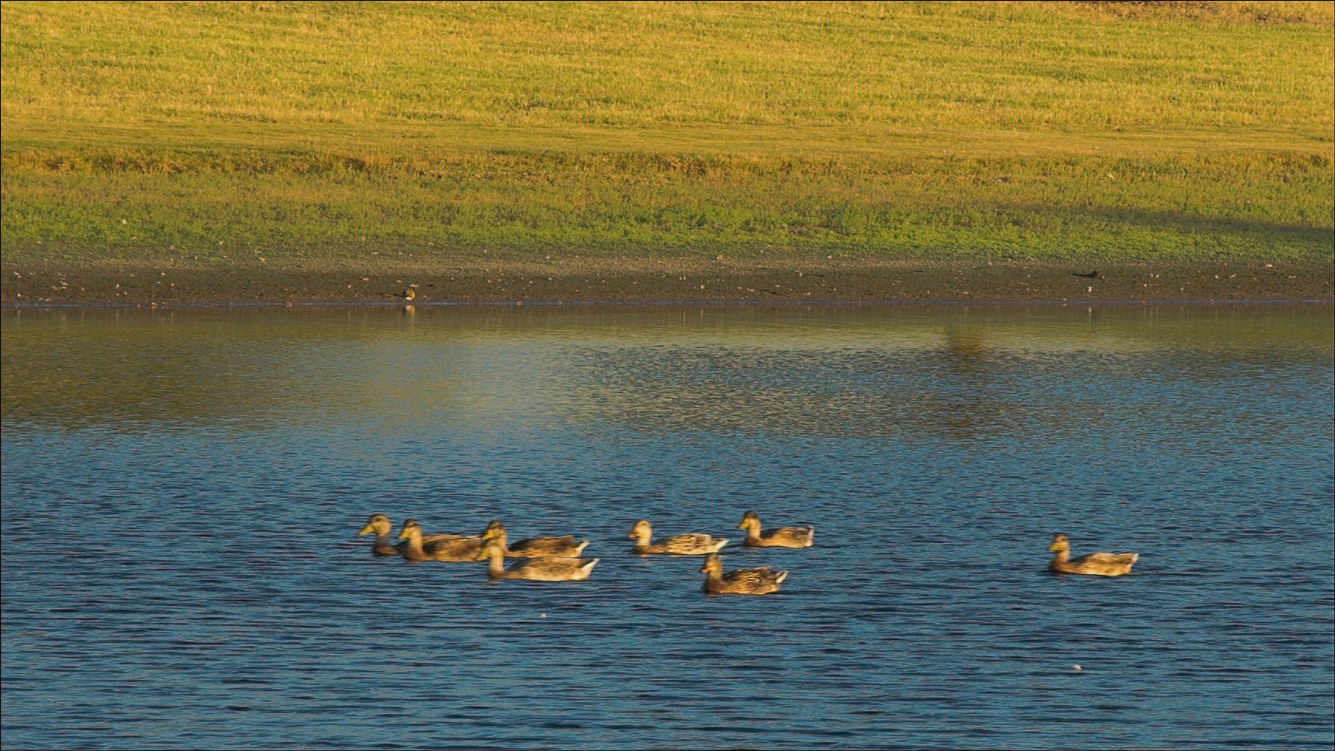

Posting some frame grabs as I've realized Youtube really compresses the images and the improvement in detail with 3X crop can't be fully appreciated.
So readers will also get an idea. I've chosen scenes which would normally be problematic with aliasing and moire in 1X mode sans VAF, and artifacting with h264 compression.
Shooting entirely in 3X crop mode-canopy1.jpg   Shooting entirely in 3X crop mode-canopy2.jpg
Shooting entirely in 3X crop mode-ducks3.jpg   Shooting entirely in 3X crop mode-ducks4.jpg

The jpegs do show more detail (see the trees) than even the HD Vimeo.

This test is for the crop mode feature and how it handles situations that is otherwise difficult with the 1X, like aliasing for instance, and how it would look with certain lenses due to the crop.
The comparisons with h264 is already done and settled. Raw is a much more flexible medium and easy and fulfilling to grade.
The crop feature has been late to evolve due to framing and corrupt frames issues, its just been recently that it's usable to a degree so that's why I decided to do this and also a previous test I did showed that a VAF while very beneficial in removing aliasing and moire, it is not ideal in crop mode, so this time I removed it prior and shot the entire test without it.
And oh, the shots with the sun are so dark and contrasty ungraded, I don't think h264 would have achieved the latitude and detail I recovered from the image.
