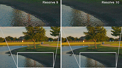

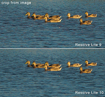

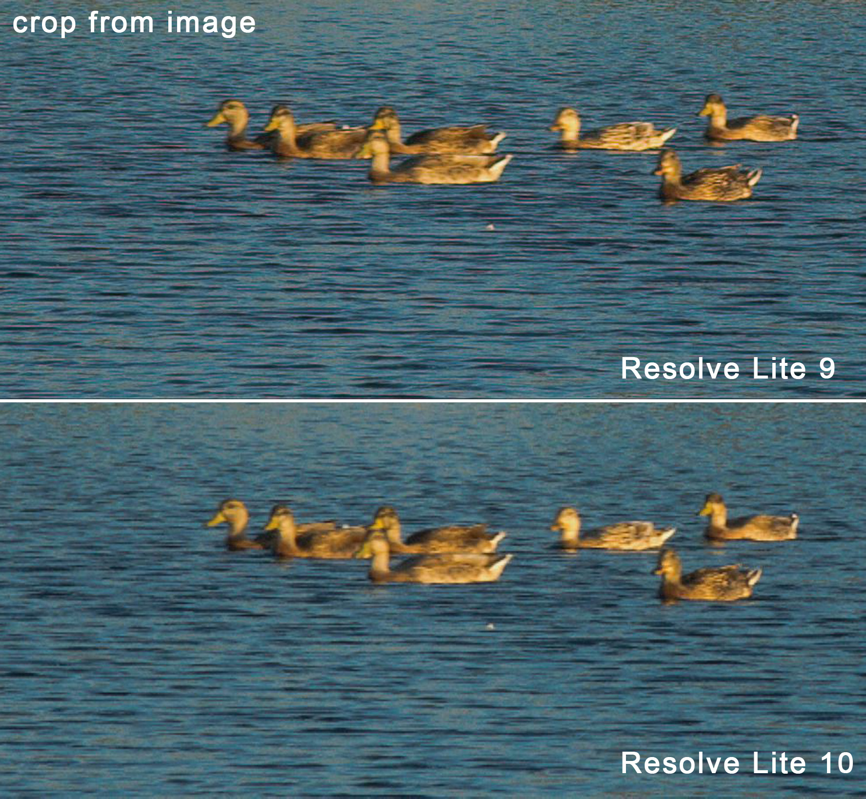

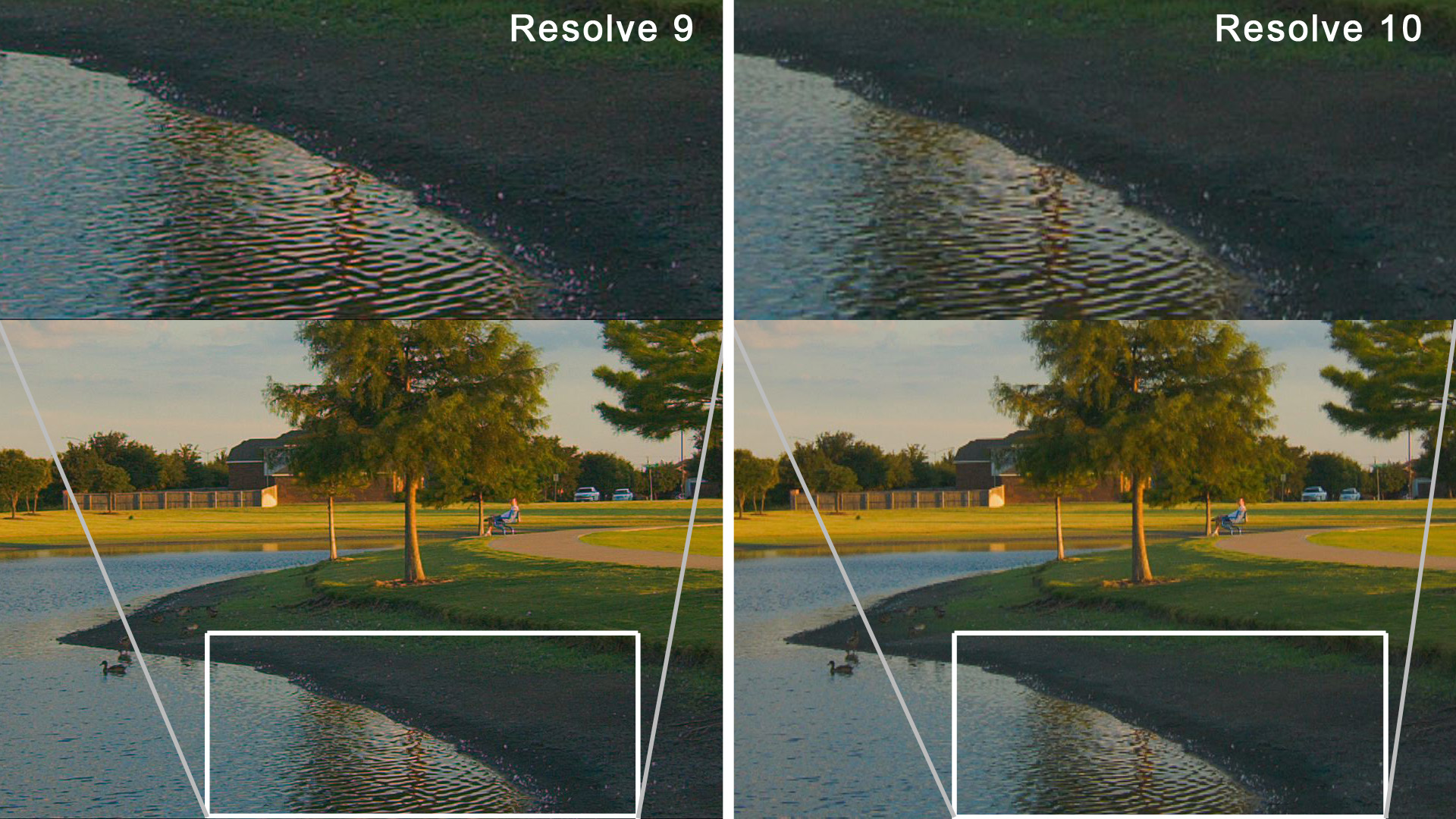

Before you have to pick 2 from GOOD, FAST, CHEAP, Now you can actually have GOOD, FAST and FREE. :D
Tested the new resolve 10 beta and so far so great. It could possibly change the way we deal with raw.
See a couple of shots I compared processed by 9 and 10.
The pink fringing which made some users dread a resolve workflow and going to an AE acr workflow which is much time more consuming in the render stage.
Now with Resolve as an NLE as well as color grade app, it might just get rid of the round tripping.
Resolve Lite 10 fixes pink fringing issues with 5D raw files-resolve-10-fix-ducks4.jpg   Resolve Lite 10 fixes pink fringing issues with 5D raw files-resolve-10-fix-pond-1.jpg
