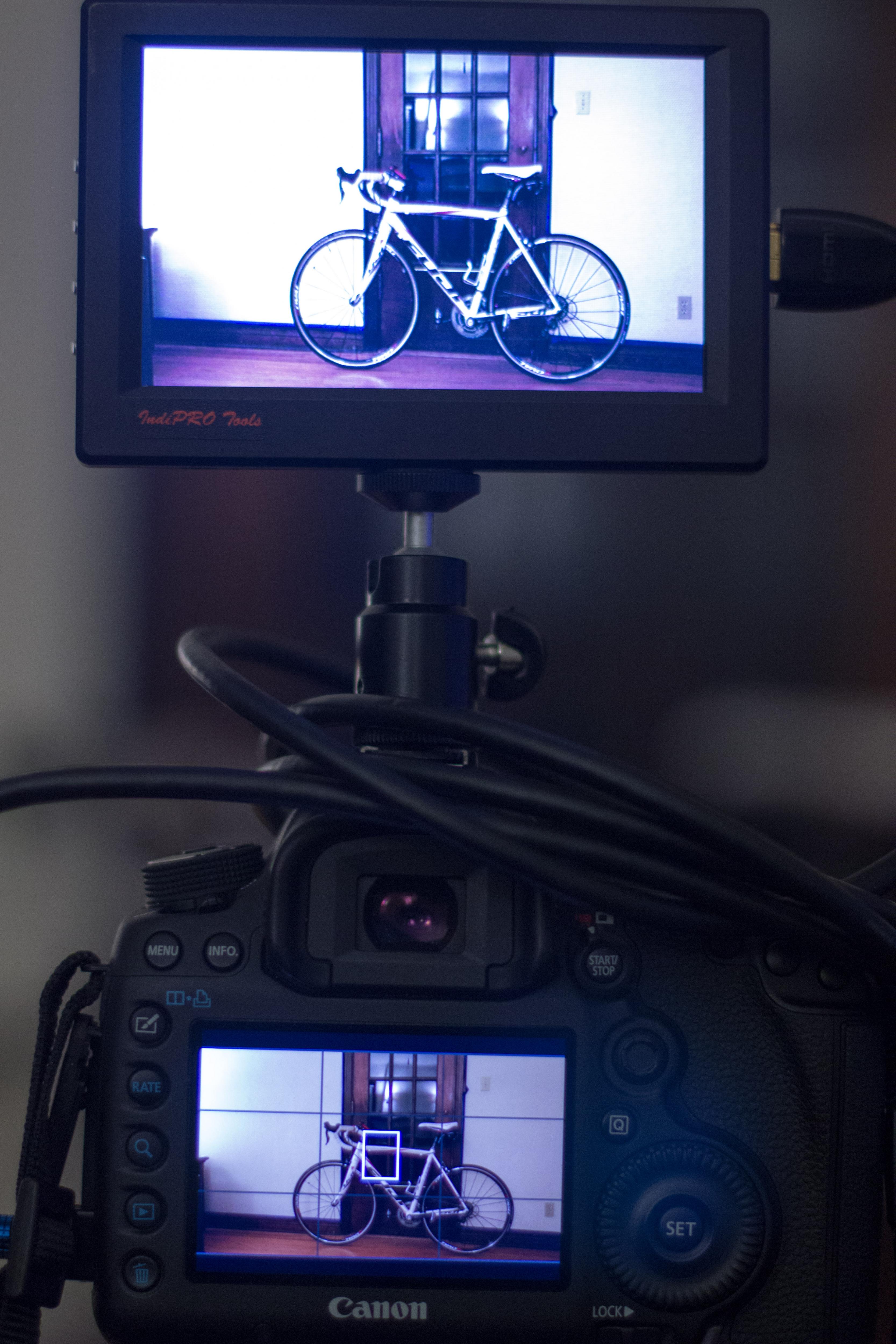

Donald, I have 1.2.1 installed and I'm able to output the same thing I see on the lcd of the camera. My 5" has native 5D Canon live output. I've also added color bars to my 5D so that I can calibrate the monitor. I have included a pic of a framed shot. I looked at the monitor that you're referring to, but I didn't want to spend the additional $$ since the resolution was 800x480.
Mounting a small monitor / evf to 5D-img_4052.jpg

Does the output shrink when you hit record?
on the 5DIII the output don't shrink, that was a "problem" on 5DII.
