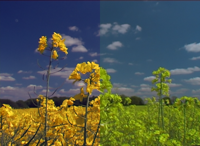

All my points, A > F, are really attempting to persuade you that outside of the Presets there is much to be explored BEFORE the Presets. Meaning, a "good" shot would/should/could be achieved in maybe not using these presets at all. But I guess you knew this? Yeah?
To try and explain and demonstrate this last statement, here is a "before" and "after" shot. The only presets used here was a white balance by me that concentrated on the getting the digital information into the camera. But in post I was able to colour correct. I'll let you decide which/what was pre and post.
Please do further reading on Presets hereabouts and do DO PLAY too!
