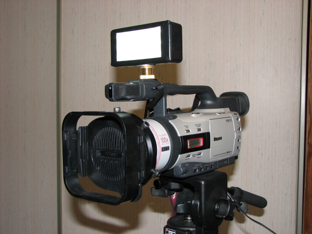

I use the Cokin system and really like it for it's simplicity, value, and great results.
I don't own the 2x converter, but I do have the 16:9 adaptor, which has no threading on the front of the lens. The universal adaptor (P486) will attach to the outside of the 2x lens and will allow the modular hood for the "P" series to snap on. A nice plus is you can get a lens cap that fits into the modular hood, so you can leave your 2x lens permanently attached!
The filters work great, but I'm not sure about the gradual filters with the 2x converter. I've not tried the gradual filters with my 16:9 adaptor yet, but I think there will be some effect with the adaptor, but there should not be a problem with a simple 2x converter.
Attached is a picture of my camera with the Cokin filter assembly attached to the front. I also added 1 lens hood to try to keep out stray light. Not bad for less then $50.00 :)
Good luck!

The adaptor ring has a groove milled into the side that the Modular Hood attaches to. The filters then slide into the slots on the Modular Hood.
All you need is the Universal Adaptor Ring, the Modular Hood, and some filters!
If the front of the 2x convertor (or any other lens attachement) is threaded, then skip the universal ring and find the exact dia ring for the Hood. Ex: the front of the GL2 is threaded for a 58mm filter, so you can buy the P458 adaptor ring. But since I have attached aftermarket bits to the front of my lens that has no threads, I now have to use the Universal Ring.
Any more questions, or pics let me know!
