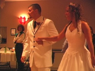

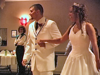

Old March 10th, 2009, 05:41 PM   #11
Location: S.B. Calif
Posts: 31
Neat Video Before and After Snapshots
Finally got Neat Video up and running. Wow, what a difference.
Michelle Genrich is offline   Reply With Quote
Old March 10th, 2009, 10:16 PM   #12
Old Boot
Join Date: Aug 2002
Location: London UK
Posts: 3,633
Hi Michelle! Thanks for remembering to post and show us the before and after - great!
Might I suggest that this shot would also benefit from some careful in-Post White Balance? Do you have the facilities to accomplish this?

Old March 11th, 2009, 07:52 AM   #13
Posts: 31
Grazie
Yes, I have the facilities to accomplish it. I put this one up because the contrast of the grain before using Neat Video and the result afterward. We did fix white balance in post. Thank you.

Don't forget to use a custom preset with your sharpness knocked down a few notches. This will help with noise tremendously.

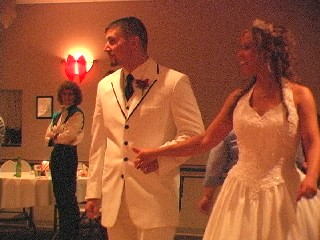

Old March 11th, 2009, 02:00 PM   #15
Old Boot
Join Date: Aug 2002
Location: London UK
Posts: 3,633
My crude attempts at WB-ing. BTW I asked and got Michelle's agreement to do this.
Grazie
