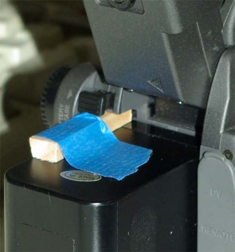

If you are not worried about camcorder beauty contests the attachd picture might work to keep the battery in place.
Abit if masking tape (or tape and color of your choosing).
(Might even be able to do it with bits of velcro.)
A piece of wood about 1/4" thick and wide (measure to fit).
Be sure the viewfinder can pivot fully.
It will prevent the battery form sliding up and off the camcorder.
