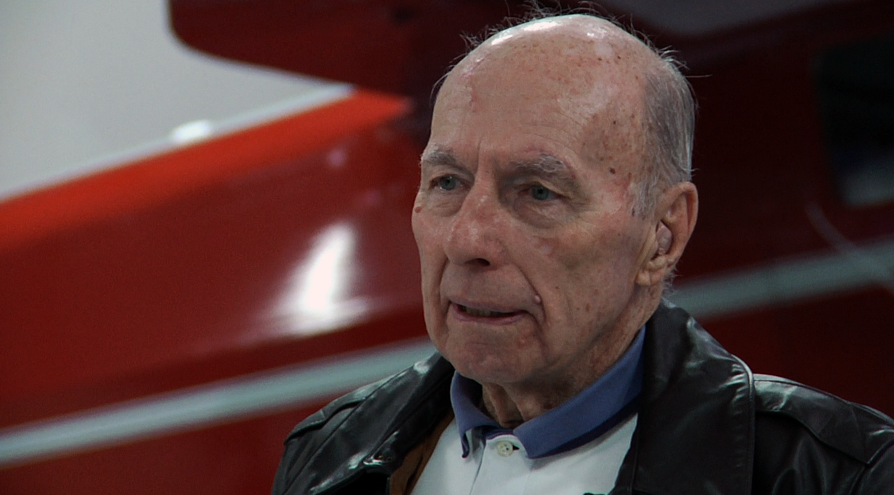

I've done this with all my cameras and told others to do it as well. Works like a charm. Though it's not always possible space-wise. I will be investing in the new Canon T2i and a 50mm lens to cover that effect in any situation. Here's a shot from my HMC150...
