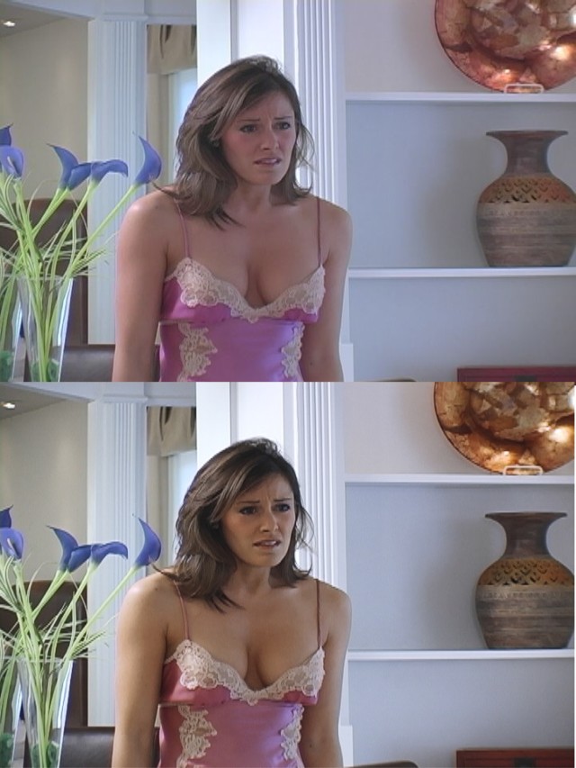

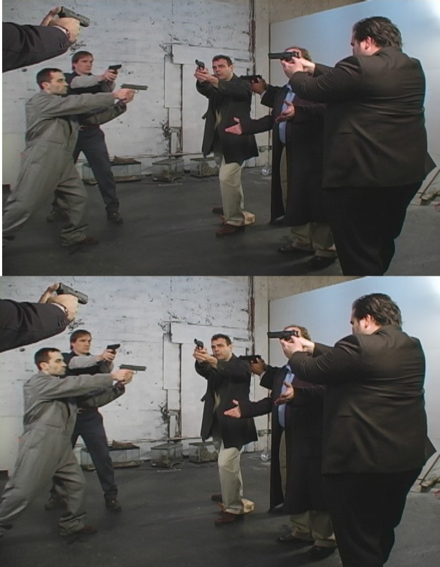

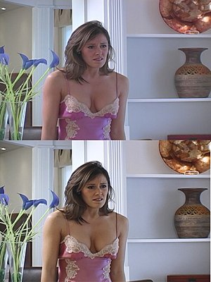

What’s going on peoples (that’s me trying to be hip…enough of that)? Here are a few stills from my feature film shot with my GL2. These are before and after stills; color graded MANUALLY with Autodesk combustion (yep no plugins!!!!!!!) Lost some resolution compressing the files to fit the size limit, but I think you can still see the difference.
Comments will be nice good or bad! The links below are to the trailer on you tube, and my myspace page.

I checked the stills, The first pics all seemed to red and the second ones seemed just right. What did you have the red green and blue set at?? what exactly did you do in post?
I watched the trailer on u tube. I am going to show it to my students tomarrow as three of them a making trailers right now.
You got my attention, I like the quality of the video. good Job!!

Thanks for the comments Dale!!!! Hope you’re ready to read?
Firstly I can’t express how important it is to have good source material! Proper lighting and all that good stuff…. I got to give a quick shout out to my DP (Erik “aka MR. Hyde” Eddings) for Lighting the scenes beautifully!!!!!!!! Also for dv anything white is your ENEMY once an image is blown out all the information in the image is pretty much gone! Unlike film dv has crappy dynamic range.
Okay now to the good stuff!!! I give the image a 2-strip effect: which is pretty much reordering the RGB channels (substituting the blue channel with green. The blue channel is pretty much crap anyways). Then I custom tweaked the COLOR SHIFT OPERATOR IN COMBUSTION this is what gives the skin tone it’s natural look. Then I add an s curve to simulate the curve of film. I then add another curve operator to boost the midtones just a little bit, and finally I add a blur to take away the sharpness.
All of the above is applied to the duplicated top layer and both images are blended together and what you get is the final results. I wasn’t going for a stylized look I just wanted the images to look good and natural.
Once again I did all of this in COMBUSTION not after effects. Please don’t ask if I think combustion is better than after effects!! This is just the software that I used, and for all of those who think “wow I’m gonna use combustion for my next Indy project”. The combustion interface is like reading Greek; it took me 2 years on and off to teach myself how to use it. And the real trick to color grading is really UNDERSTANDING COLOR THEORY!!!! Once you figure that out color grading is really easy.
Hope that was helpful!!
