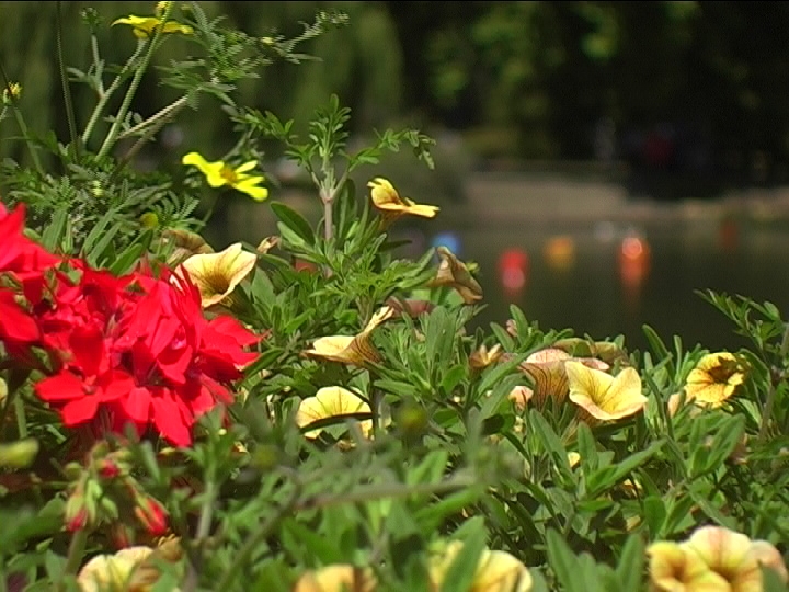

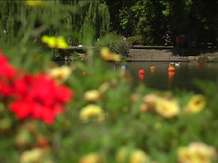

I've attached 2 examples: Far and Near Focus. I've "thrown" the focus while capturing.
It was a very VERY bright day. I could open up the iris completely; I slapped on extra NDs to bring back exposure within limits; I used a polariser to get that real neat saturation without all the OTHER light bouncing about and I think this demonstrates just what this small chip camera can do with "some" extras.

Thank you Cole. I just hope they demonstrate what you can do with the setup I explained?

I got both pictures nicely. Great demonstration of depth of field for anyone who wants to know how to get that look.
I always use both nds and a polizer, I really like the look.
