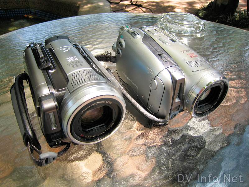

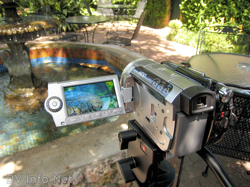

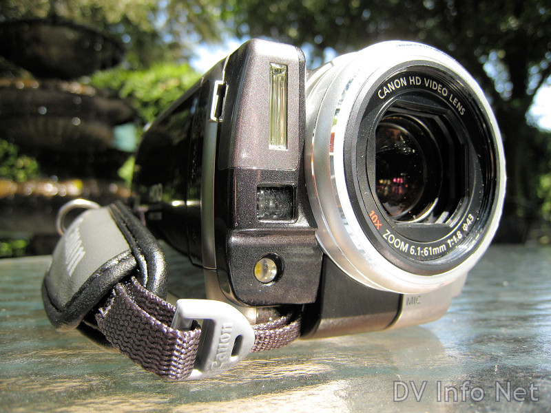

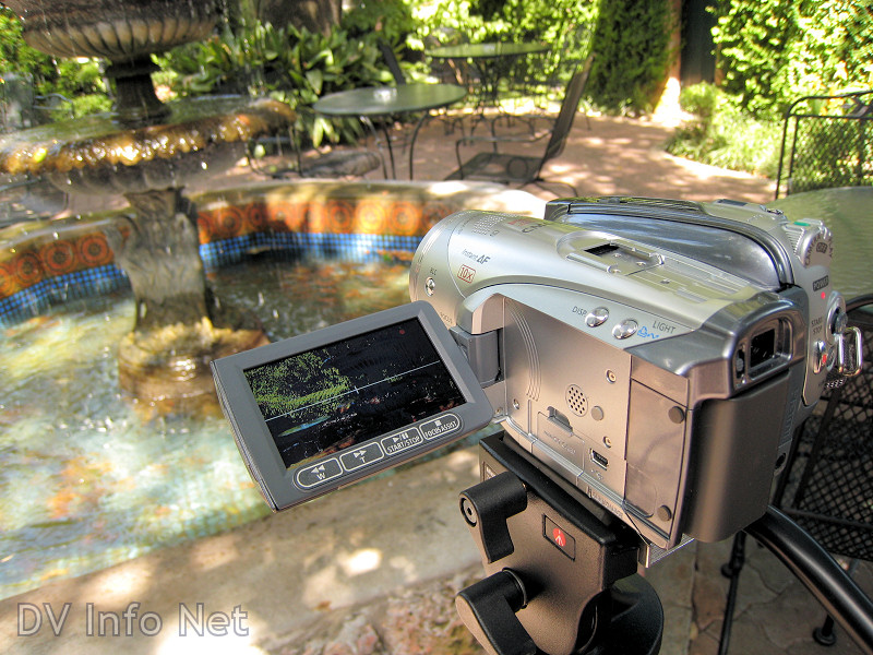

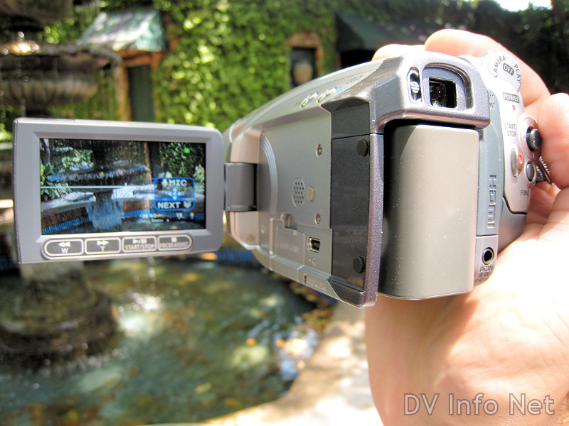

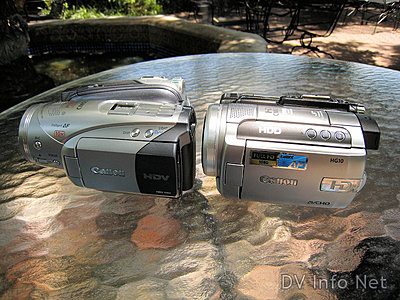

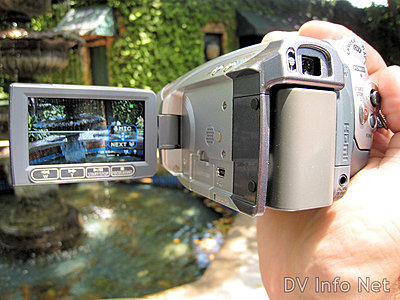

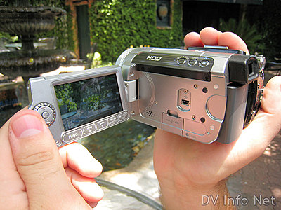

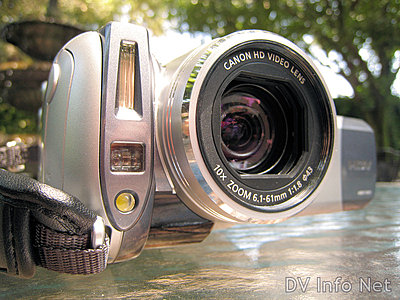

Props to DV Info Net member (and fellow Longhorn) Austin Meyers who drove down and met me earlier today so we could pit the new Canon HG10 side by side with the Canon HV20 in a "most other things equal" test between AVCHD and HDV. This will develop quite a bit, but I wanted to at least show you some pics tonight (click the thumbnails to see 'em big) and we'll have a lot more input to follow.
Canon HG10 and HV20 side by side -- pics-hg10-tt1.jpg   Canon HG10 and HV20 side by side -- pics-hv20-tt1.jpg
Canon HG10 and HV20 side by side -- pics-hg10-hh1.jpg   Canon HG10 and HV20 side by side -- pics-hv20-hh1.jpg
Canon HG10 and HV20 side by side -- pics-hg10-tr1.jpg   Canon HG10 and HV20 side by side -- pics-hv20-tr1.jpg
Canon HG10 and HV20 side by side -- pics-hg10hv20tt1.jpg   Canon HG10 and HV20 side by side -- pics-hg10hv20tt2.jpg
Old August 9th, 2007, 12:42 AM   #2
Posts: 27,382
My apologies in advance to Austin for stealing some of his thunder, but here is the quick rundown of what he observed regarding camcorder features... I'll let him expound on this in a little more detail at his convenience about these significant differences, but I wanted to go ahead and briefly get the word out now:
1. Focus Assist: unlike the HV20, the HG10 does not have Peaking (although it does have Magnification).
2. Exposure Monitoring: unlike the HV20, the HG10 does not have Zebras (HV20 has 70% and 100%)
3. Audio: unlike the HV20, the HG10 does not have manual audio level control (it does have a mic input).
4. Manual Focus: Austin said he prefers the ergonomics of the HG10's selector wheel over the HV20's dial.
Lots more to follow (about features and ergonomics... plus video, both 60i and 24p). Stay tuned,
