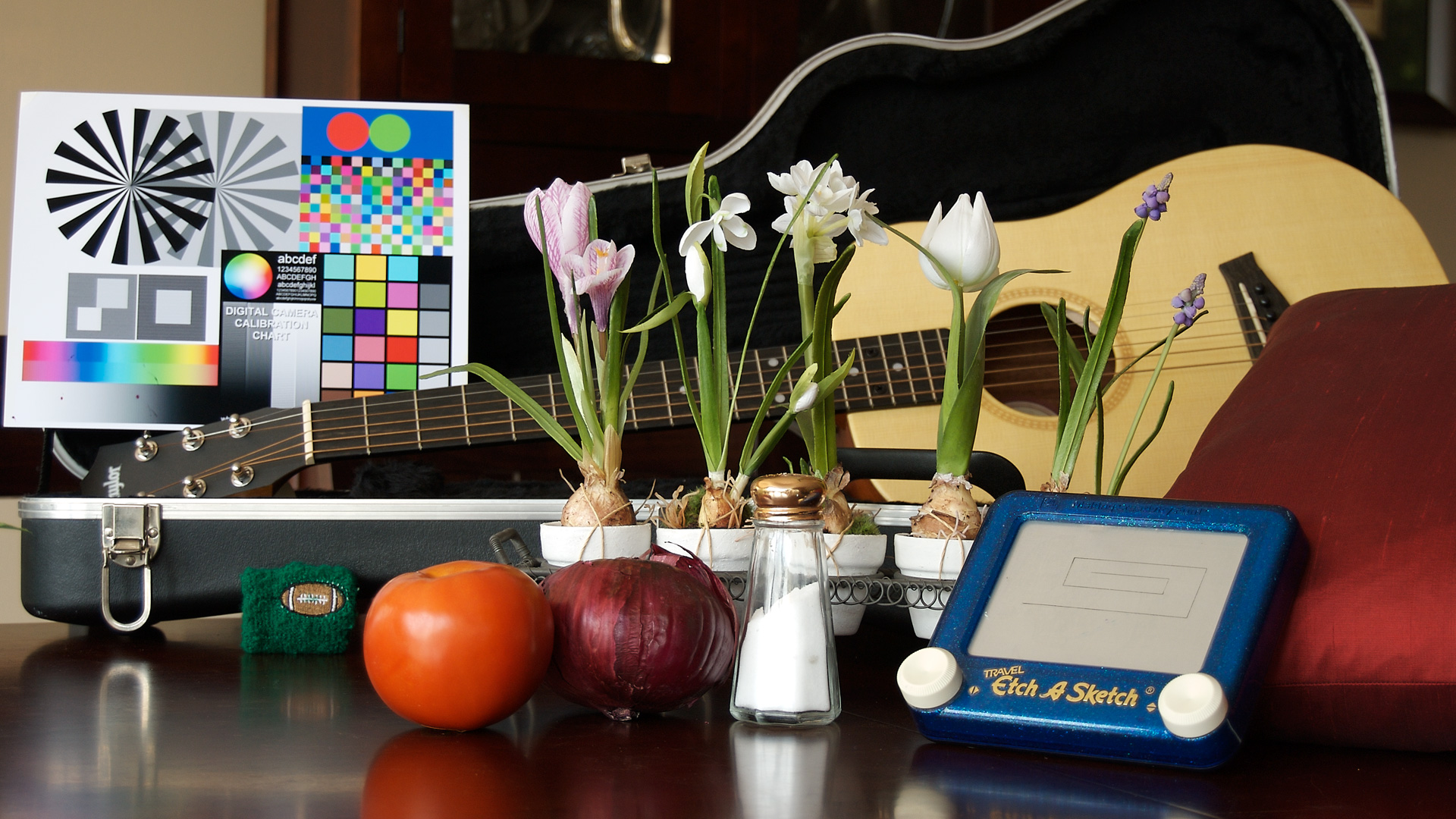

Here's the new set-up. It's got a little bit of everything in it, strong highlights, rich shadows, subtle textures, bold colors, subtle colors, etc.
I shot every different custom image setting through -1,0,+1 in both Tv and CINE mode.
I'm going to put them all together as one layered in Photoshop file, as that seems to be about the easiest way to compare.
(FYI, I'm heading out of town, so I might not be able to post it until late in the week.)
