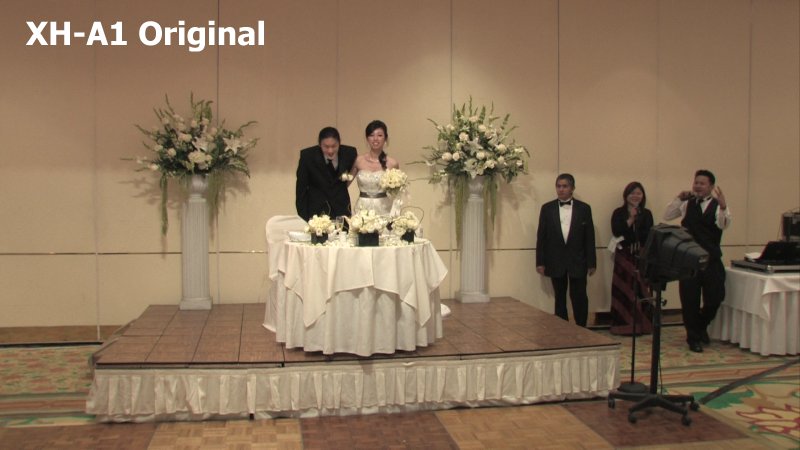

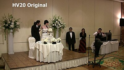

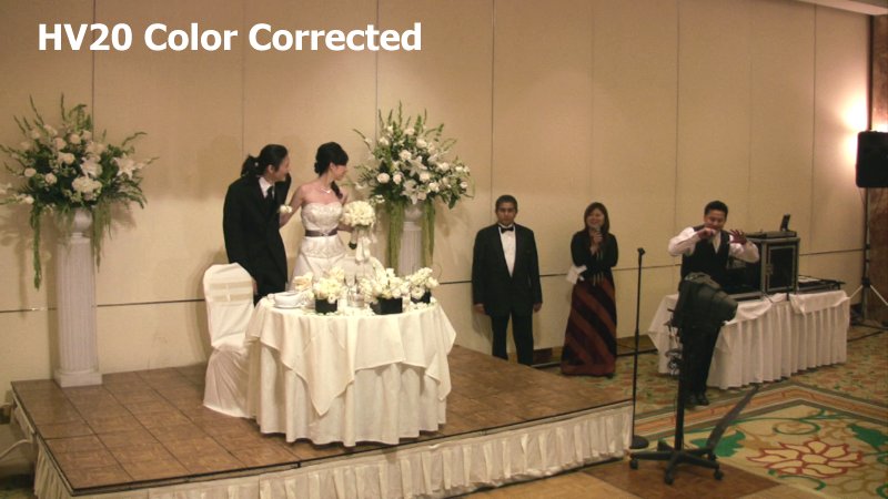

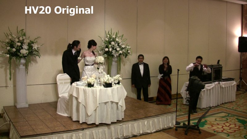

I just did a color matching with clips from XHA1 and HV20. This one seems to be a lot easier to match. I noticed if there're a lot of RED in the video, it makes it very difficult to match.
I shot both full auto mode on both XHA1 and HV20. Match them using Matrox color correction. The result is pretty darn close.
To me, the A1 looks reddish-bluish, and your color-corrected HV20 looks too bright and yellowish, still not an exact match. Original HV20 footage at least almost matches brightness-wise. But maybe this is just me, I am not trained to see subtle differences.

HV20's original footage is way darker in other scenes than A1. I'm not expert in color correction. This is the second time I did it. There're room to improve.
