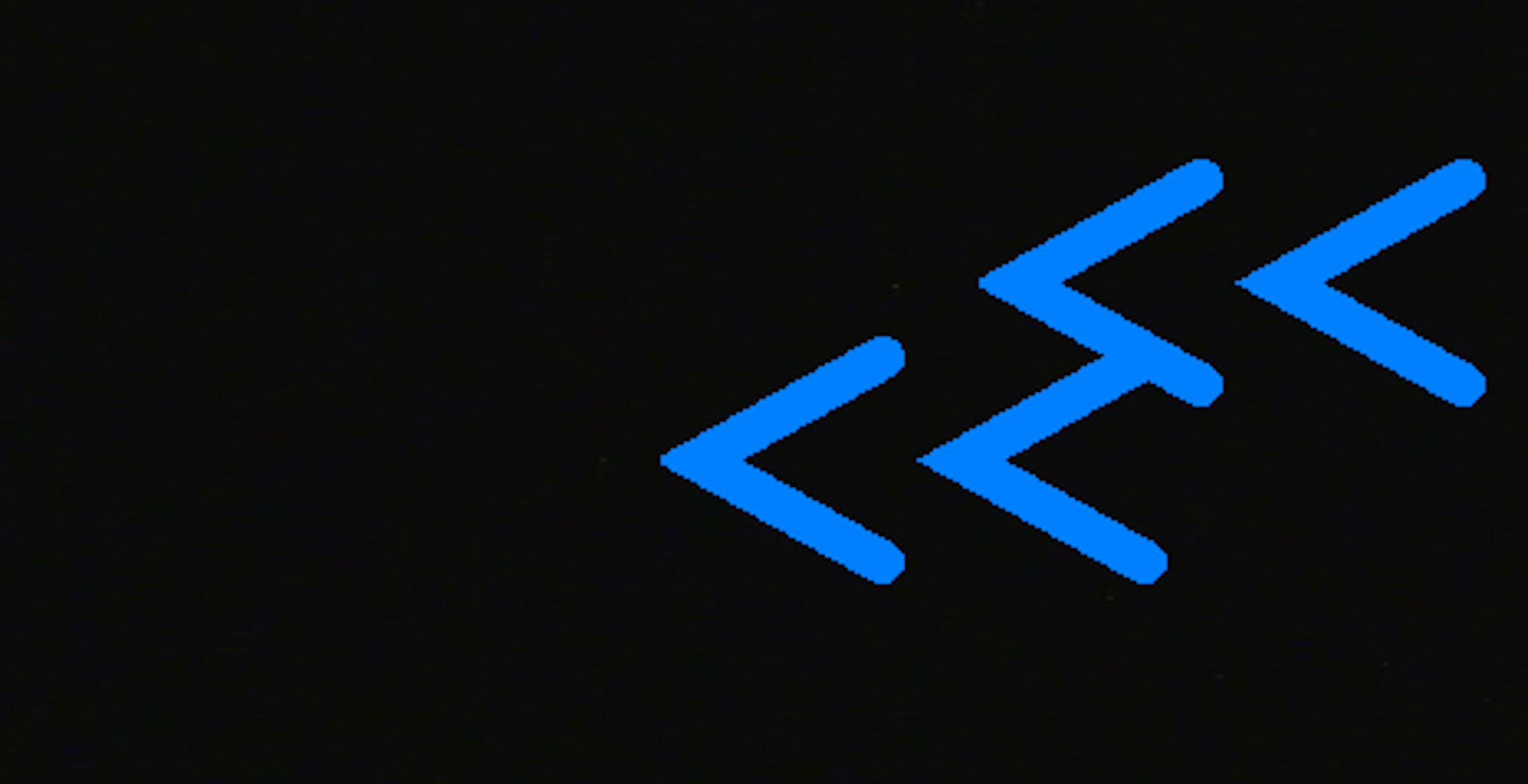

Guys, got some strange stuff, captured some footage in absolutely dark area (so video is black) in cine mode, than I watched it on monitor and found some dead (?) pixels. Some bright dots all over the picture, they are appearing and disappearing. In automatic (and any other) mode there are no such issue, maybe because there are a lot of other noise, but in cine mode I’ve got this:
http://vorobfiles.narod.ru/snapshot20090121102523.png
It was hard to capture screen, but think you’ll see if you zoom parts with arrows.
Anyone here with HF cameras, can you make same video? Absolute darknes + cine mode, video about 5 sec, just to compare.
Thanks.

Dima,
I downloaded your sample and looked at the areas your blue arrows point to and under maximum magnification saw nothing but black. I don't see anything to indicate you have a problem with your camera. If what you see appears and disappears you may simply be seeing transient artifacts caused by your monitor.
If what you're seeing is on your LCD fold out screen, again nothing to worry about.
Just relax and enjoy the camera.

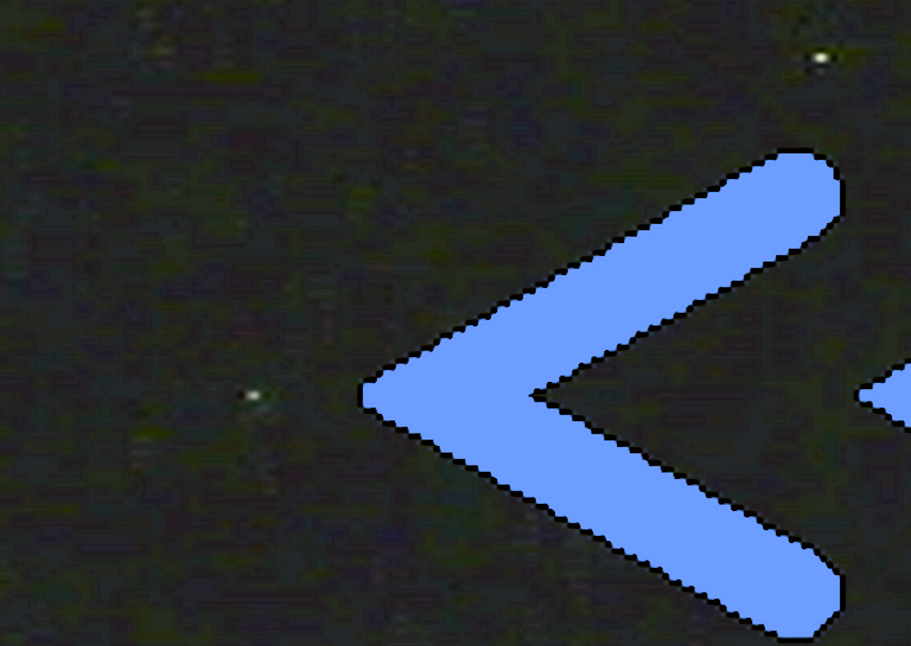

I cropped the image you sent and enlarged it about 500%.
I cannot see any of the defects you are referring to.
I have attached the enlarged crop. Do you see the "stuck pixels" in this image also?
Your HF camera seems to work the same as my HF100 based on the prior post and frame grabs you posted in the forest. I think your camera is working correctly.
Larry

I can see the dead pixels in that 500% enlargement.

So can I, but I doubt that you'd notice them on live video...

I had to adjust my monitor gamma in order to see the pixels which were not black. At normal (unmagnified) 1920 by 1080 they are now visible but only visible if you really look for them carefully.
I have further enlarged the crop by another 3X, to a total of 15X, and shifted the gamma to emphasize the dots, so at very high enlargement they are very visible. I have attached this further enalrged, gamma shifted crop to show where they are.
Personally I would not consider this a flaw in the camera, particularly if these dots move with time rather than appear as stationary "stuck" pixels as you originally stated.
Larry
