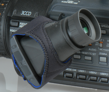

Here's the solution I found. Hoodman Hoodloupe 3.0 with the camcorder strap. From hoodmanusa.com, picture should show below. I also often use the cinetactics.com Screen Hoodie30 .
