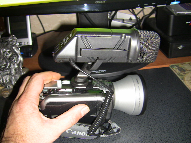

I have the Canon WD-H43 Wide angle lens on my HG10 as well as my HG21 using a stepup ring and suffer from none of the the problems you state.....I find it a must have in my filming projects.......
