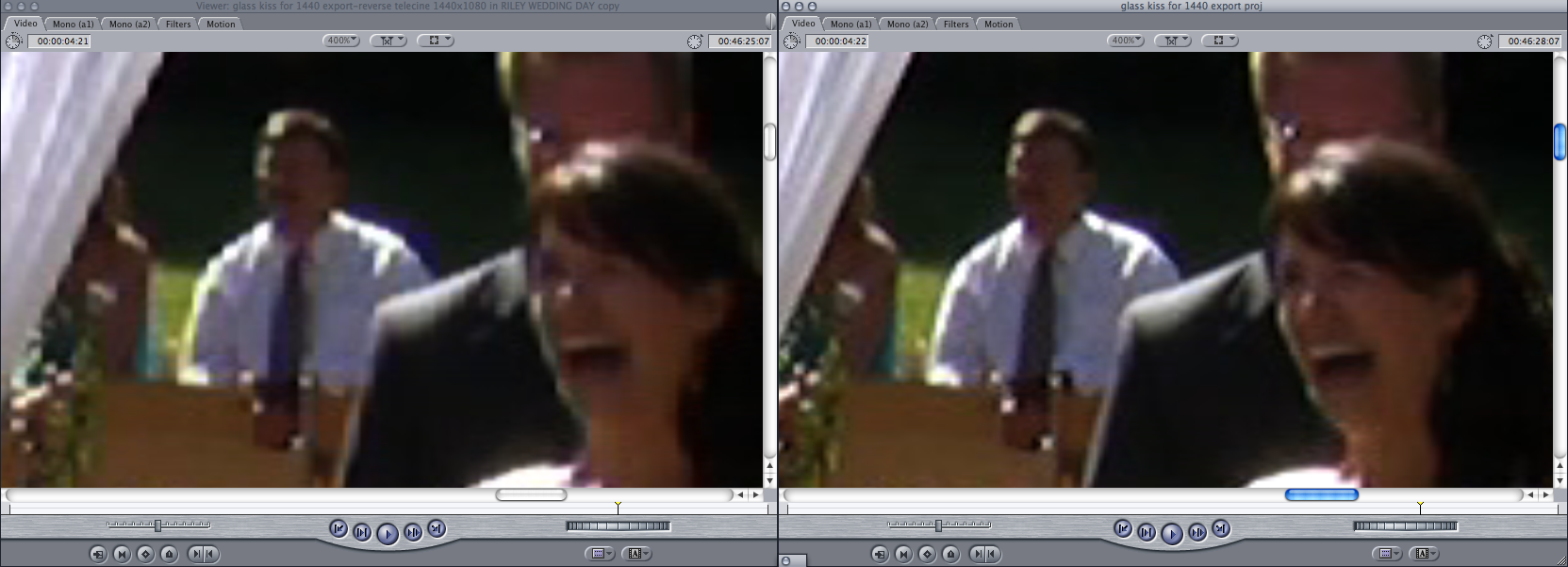

On an Apple I do this process with a Compressor droplet and have also done tests with JES Deinterlacer. Both degrade the image but JES produces a better result, but because of JES's clunky interface I use Compressor more often.
The comparison shot is Compressor on the left and JES on the right at 400%. You can see how chunky the Compressor conversion is compared to JES. Both are noticeably softer than the original. (The next time I need to do this process I'll grab stills of the original too.)
