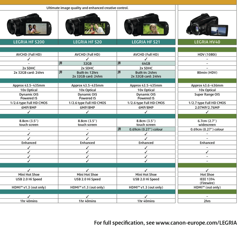

According to the Canon brochure (download from their site - extract below) of the recent Vixia/Legria series only the HF-S21 has a viewfinder (which, by the way, can be extended backwards, but will not tilt). I'm still trying to decide between one of these Canons and the Panasonic TM700.

HV 20/30 and 40s do have viewfinders , HF 21 do look impressive but if i was paying that much for a consumer cam now i would choose the PANASONIC TM 700
